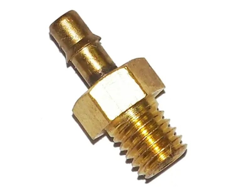

For our horse tack room and the garage bathroom I bought two small dehumidifiers from Amazon. They have a small pull out water collection container at bottom. I drilled a hole and threaded in a small hose adapter, putting JB Weld on threads. Then aquarium tubing going outside, 3/8" hole drilled through wall. They work well & never have to empty container.
