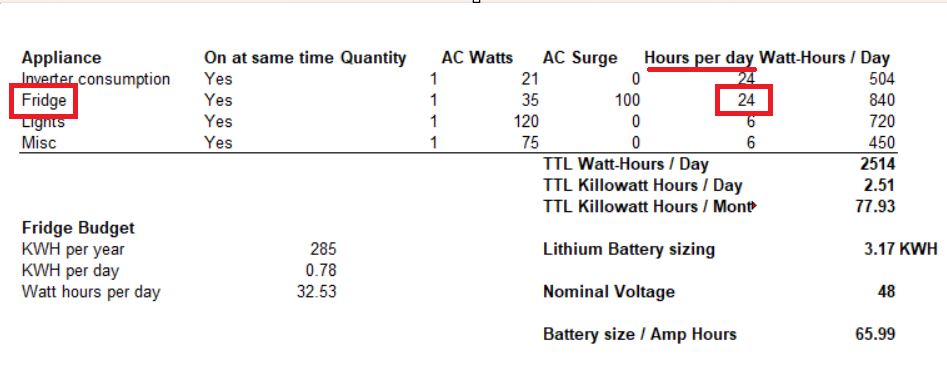

So, the refrigerator runs 24 hrs/day?
/ off-grid solar for camp #44
So average, not actual watts?
/ off-grid solar for camp #45
And 100 Watts on Start Up?
Go ahead and try it. More like 1000w Start surge, 700w running
I was using a 1000w Pure Sine inverter and a 8cu/ft Chest Freezer. But the 12v 11cu/ft Fridge actually burn less amps and is far more convenient to use.
As stated 4, 100w panels on the roof (SW), 1, 195w panel for morning sun (SE). the fridge stays on all summer. A little help when we are using more, however it would run Weekends (in sunny conditions). 6, 6V LA Golf Cart Batteries.

Below is what my solar pro guy is thinking and the fridge was properly calculated, all the numbers he sent me just weren't updated
Here is 12v refrigerator consumption.
12-volt compressor refrigerator/freezers typically consume between
30 to 60 watts while the compressor is running. However, because they cycle on and off, average daily consumption is much lower, generally ranging from 240Wh to 600Wh per day depending on ambient temperature, insulation, and usage
100 amp hour needed battery if mostly summer only fridge use.
3 panels -- 1200 watts but 4 panels would be OK for extra.

My 10.3 Cu/Ft Fridge Actully draws 72w 6A@12V while running. 12' 10awg wire run
Your forgetting the money factor. 12v fridges cost alot more. So the KW savings really may not be here vs the 120v version.

We of course have looked at the dc fridge pricing..... We will be using LiFePO4 batteries and some dc/ac converter. I've got a fellow working on all this who is and "expert" were as I am not..
