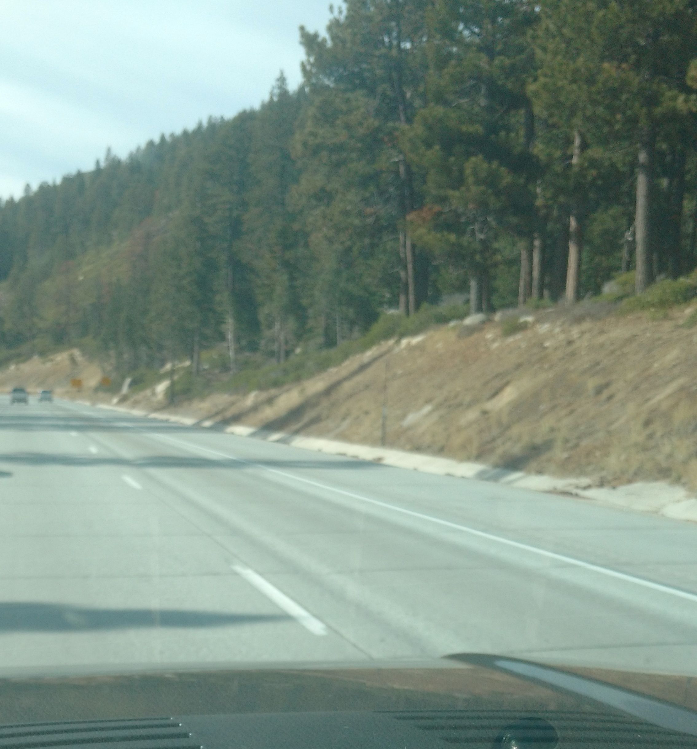

I travel over Donner Summit (I-80) between Nevada and California pretty frequently.
This section was entirely refurbished a few years ago. I watched the concrete pour and it seemed like about 14 inches thick with lots of rebar. Now, a few years later, I am seeing ruts in the concrete in the truck lane.
The ruts are so bad I can't use that lane when towing a trailer. The trailer wheels are a little wider than my truck, so if truck wheels are tracking the ruts then the trailer is not-- making it wander around.
I don't ever remember seeing ruts in concrete. Is this possibly a bad mix of concrete that has caused this?
It was worn that bad or worse before the resurfacing about 10 years ago. I think the intended design life for the surface is only 20 years and it was well past that.
Apparently trucks even without chains will eventually cause damage like that. 100 miles west of the summit over in the flat Central Valley, I-80 looked nearly that bad in stretches between Sacramento and San Francisco before repairs a few years ago. That project is nearly finished but there are spots where water got under the pavement and the sub-base got pumped out by individual roadway panels breaking loose and rocking, as trucks went over them. I drive that nearly weekly between home/ranch and see the crews who set in new panels still have their equipment staged ready for overnight work.
