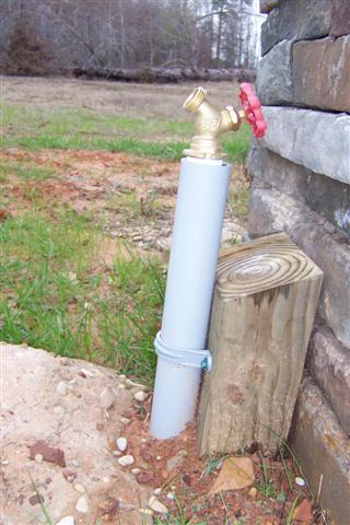

I've attached a picture of what I thought was a very clean, nice looking setup from an RV Park that I visited. It's sleeting and raining outside, but if you can wait for it to clear up, I also have a few that are done at my place.
I run a one inch water line to where I want the spicket. Then I reduce it to a 3/4 valve. From the vavle, I run 3/4 pipe to where I want and 90 it up to my desired height. I put a 3/4 to 1/2 inch threaded male fitting on the end.
Next I slide foam insulation over the pipe from the threaded end to the 90 in the ground. I tape the end at the top and a few places along the length to keep it together.
Then I slide a piece of 1 1/2 inch Grey PVC Conduit over the insulation. This also goes down into the ground to the 90 and ends flush with the bottom of the threads of the male fitting on top.
I use half inch female brass boiler spickets. They thread onto the pvc male fitting and have the water hose connection on the side with the valve handle on the top.
then I put a piece of Preasure treated wood along the back of the Grey PVC Conduit. You could hammer it into the ground a little, but I don't I attach two 1 1/2 inch pipe clamps around the Grey PVC Conduit to the Preasure Treated wood. The wood ends a few inches below the top of the conduit so I can turn the water on and off easily.
I've made it through 17 degeee tempatures without it freezing and for the last three days we've had a high tempature of 34 degrees without any problems. If you get allot colder, you might need more insulationa and a bigger cover pipe to protect and cover your insulation like in this picture.
Again, just ask and I'll get a picture for you in a day or two of what mine look like.

What I need to setup is for more a extreme usage scenarios. The trailer is for part time use. Sometimes it could be months in between uses. It's not heated. I would run out of propane if I leave the heater on....Everything is turned-off and I drained all water tanks. So far, no brusted pipes or anything yet. My water is in a temporary above ground storage tank. Not insulated. Water inside the tank didn't freeze. However, everything around it was frozen. There's water in the tank but I can't get it out. Last weekend, I had to break a layer of ice on the surface and scoop water out with a bucket. I spent hours trying to figure out how to get a few gallons of water out of the tank. No water hookup to the trailer. That means no hot shower. Not fun after driving 300 miles to enjoy my rural property.
I'm in the process of planning my water system. It will be 2x2500gal storage tanks located about 100' above the homesite/trailer. The well is about 30' away. I've installed a solar pump. I want to be able to continue pumping water even during the extremely cold season. As you may already knew, I have a very low yield well. Less than 2gal/min. So, I need keep pumping when the sun is up.
I will burry 1" PVC pipe from the well to the tanks. 2" PVC pipe from the tank to the homesite/trailer location. I'm trying to learn what's the proper water piping system for cold weather. Also, what's the best method to keep the exposed pipes from freezing? Thanks for your help.

Thanks Eddie. I love to see the picture and get a better understanding of your setup. Last weekend, it was below 10 degree at night and in the 20's during the day even though the weather forecast says high in 40's. I am suppose to be in a very mild climate zone. I guess it's different for RV hookup than a typical home. The freezing effect is more severe because it's not being used frequent enough. Whatever I plan to installed, it must be a passive system. I don't have anything to generate heat or have a source of constant power.

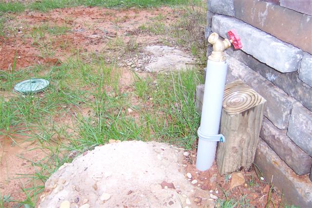

Here are a couple of pictures of what one of mine look like. This one is on the backside of my sign at my entrance, so it's a little on the low side. I'll be putting sprinklers on the line in the future, and this will just be there for cleaning or maybe washing off the sign.
I'd forgotten about how low it is when I posted ealier, and that it's spicket is actually angled up. This just seemed better for it's future needs.
There is a green circle in the ground that is the access to the valve.

Eddie, as an RVer, I sure hated to see that kind of faucet for a couple of reasons: (1) I always put my pressure regulator at the faucet, so it not only protected the interior plumbing of the RV, but also my water hose, and adding anything between the faucet and hose means it sticks up that much further and the hose has a sharp bend to go down, and (2) if they're just a little bit low, I've seen too many male dogs use them for the toilet. The faucet should be installed so the water comes out running straight down, which means a different kind of faucet, or at the very least, an elbow just before that faucet.
   / RV water hookup for cold temperature #12
Sorry Bird, I wasn't very clear. The one in the picture is not for RV use. It's for a flower garden that will be around my sign. It's a totaly differenty type of spicket than what I'll use for the park.
I was hoping the picture would show how I insulate my water lines. 3/4 inch schedule 40 PVC. Then there is pipe insulation around that and the 1 1/2 inch grey conduit slides over the insulation.
It's a cheap, simple way to do it that I've seen in other parks and should work well on a home application. How much cold it can handle is a mystery. It's worked well at my place down to 17 degrees over night, and three days of freezing temps in the 20's to low 30's.
Sorry for the confusion.
Eddie

I misunderstood, Eddie. It looks good as far as the insulating and for what you're going to use it for. Of course for any spigot, I do prefer one that shoots the water straight down. To me that's just easier to hook up to and less bend in the hose.

Thanks for posting the pictures. Do you have to shut the water off at the underground valve after each use?
   / RV water hookup for cold temperature #15
I leave the water on at the valve all year. The reason for the valve is that these thing get busted. Vandalism or just bad tractoring. hahahaha
There's actually three valves on that line because of a few other lines I may add in the future, but that's another story.
Eddie
