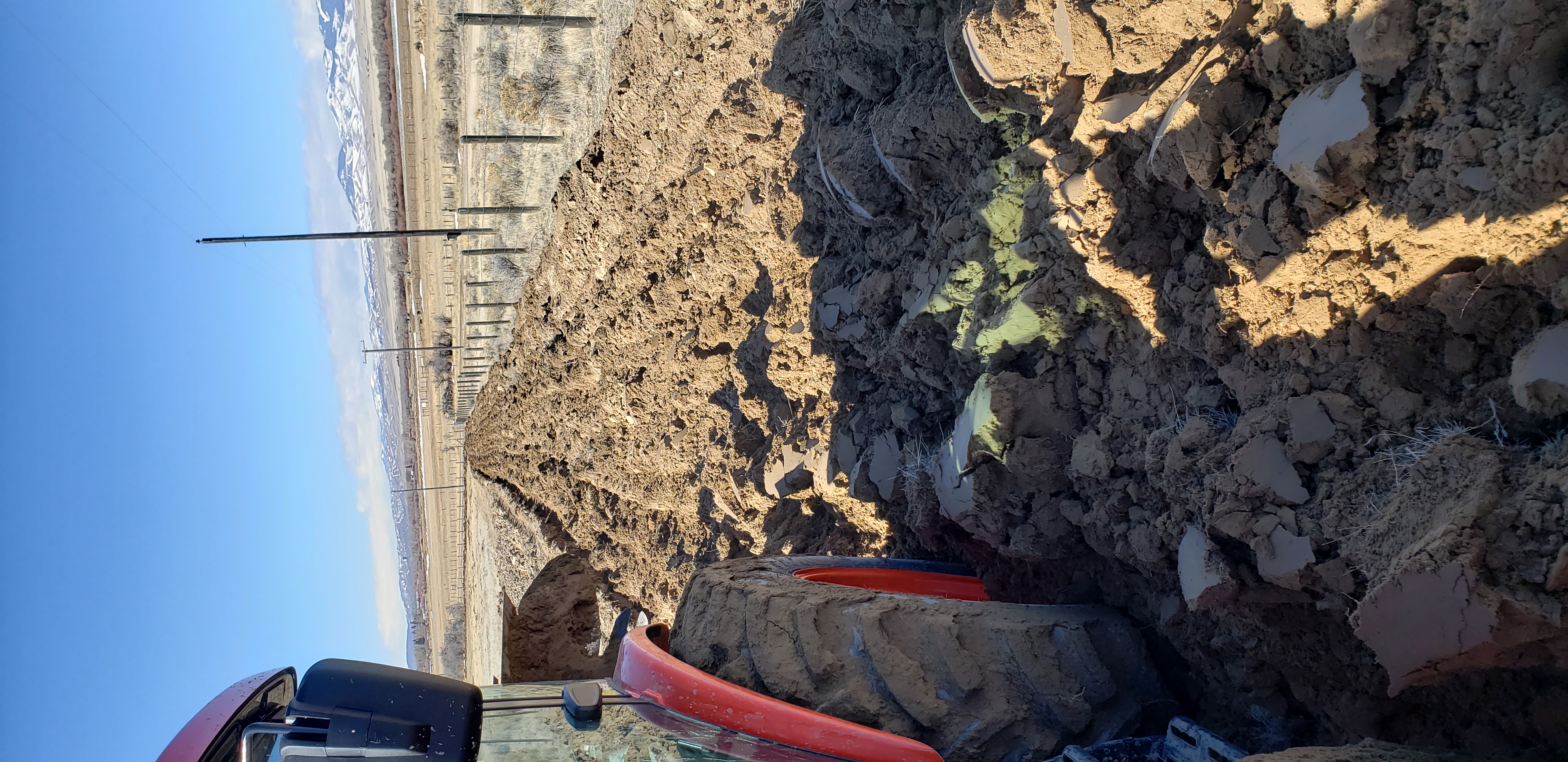

Im so freaking over this POS tractor! Plowing the field today I must've gotten into a soft spot or a bit of a hill where the plow took a bigger bite and the engine lugged down and died. Now it wont restart. Just finishing my 4th pass...so maybe 15 minutes of work. 20190331_113557.jpg

Nope, still isnt starting. I let it set for a few hoping that would help and just went and tried again. It died from bogging down. I dont know why it would be hard to start because of that. It turns over like its trying...like a bit faster that it would on just the starter alone.

It sounds like a fuel problem,
filter? can you check for flow from your filter?
or possibly your fuel shut off solenoid.
I don't know if yours is energize to run or energize to shut down,
but you may be able to disconnect and manually set it to find out.

Sounds like a fuel issue, maybe shutoff solenoid, do you have a manual plunger on the solenoid you can push in and out a few times?

What a disappointment. I'm sorry to hear you're having more trouble. I don't remember but does this machine require the shuttle to be in neutral?
