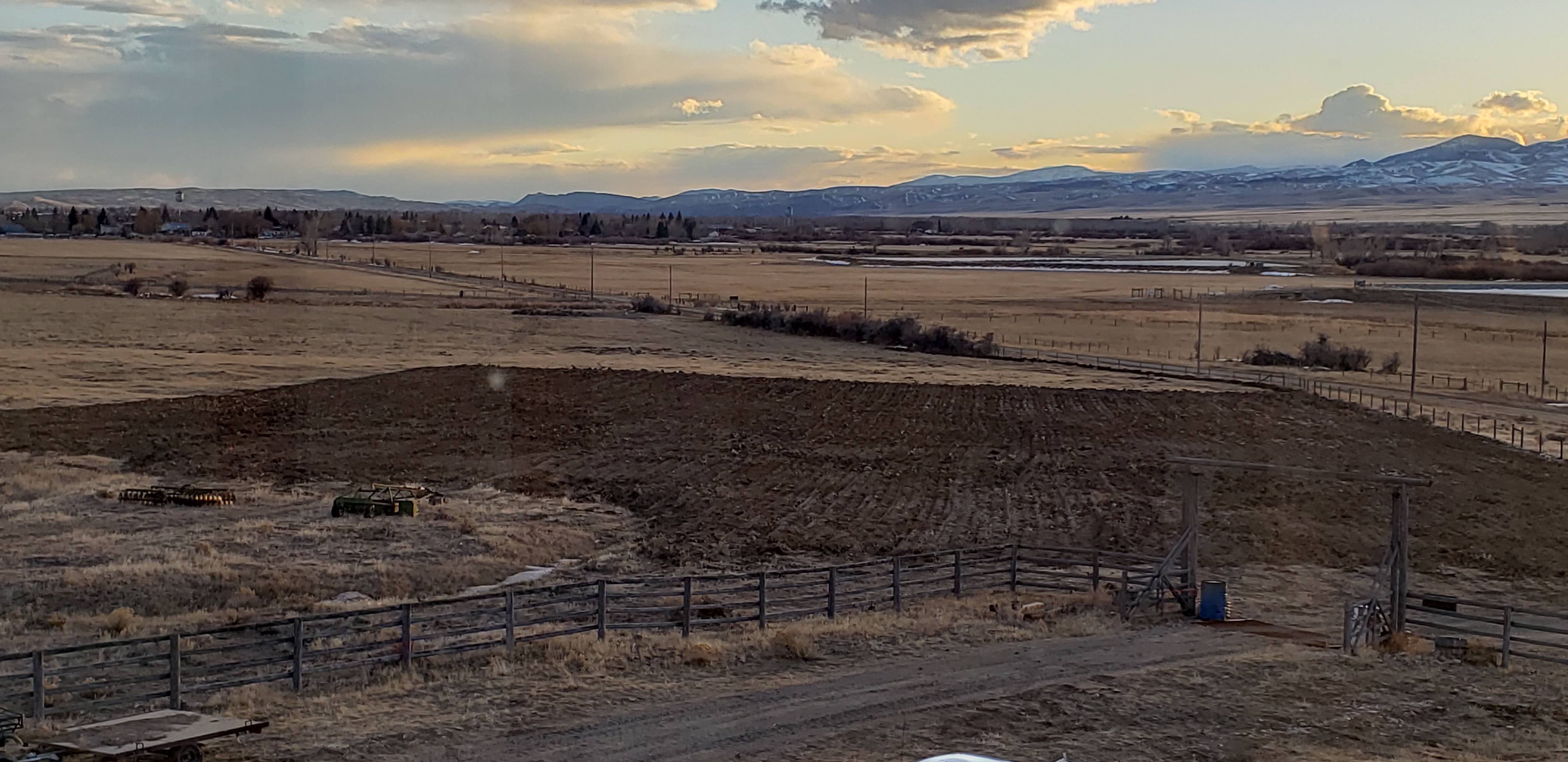

Yeah, if any of the safety concerns are not met it just flat will not turn over. It was turning over fine, and like I said, it was even turning over faster than it would on starter alone; like it was firing just a little bit but not enough to stay running. Kinda how a flooded gas engine acts as ya start to clear it. Never heard of it before, but can a diesel engine flood? After a couple hours it just started like there never was a problem. I got a little bit of work done and a few more questions I will post in another thread for someone that has spent some time on a mouldboard plow.

Field looks good.

The field does look nice. While it was running how did it pull those 3-bottom plows?

It pulled them well. Most of it was done in medium range, 1st gear at 2500 rpm. Occasionally I wouldn't be quick enough on the draft control lever and I'd have to push the clutch in then restart in low range, 4th gear. Traction wise, it did great. I plowed with a bucket full of wet snow in 4wd. Might have done even a bit better with a bucket of gravel, but in the gear I was in I would run out of power before traction for the most part.
