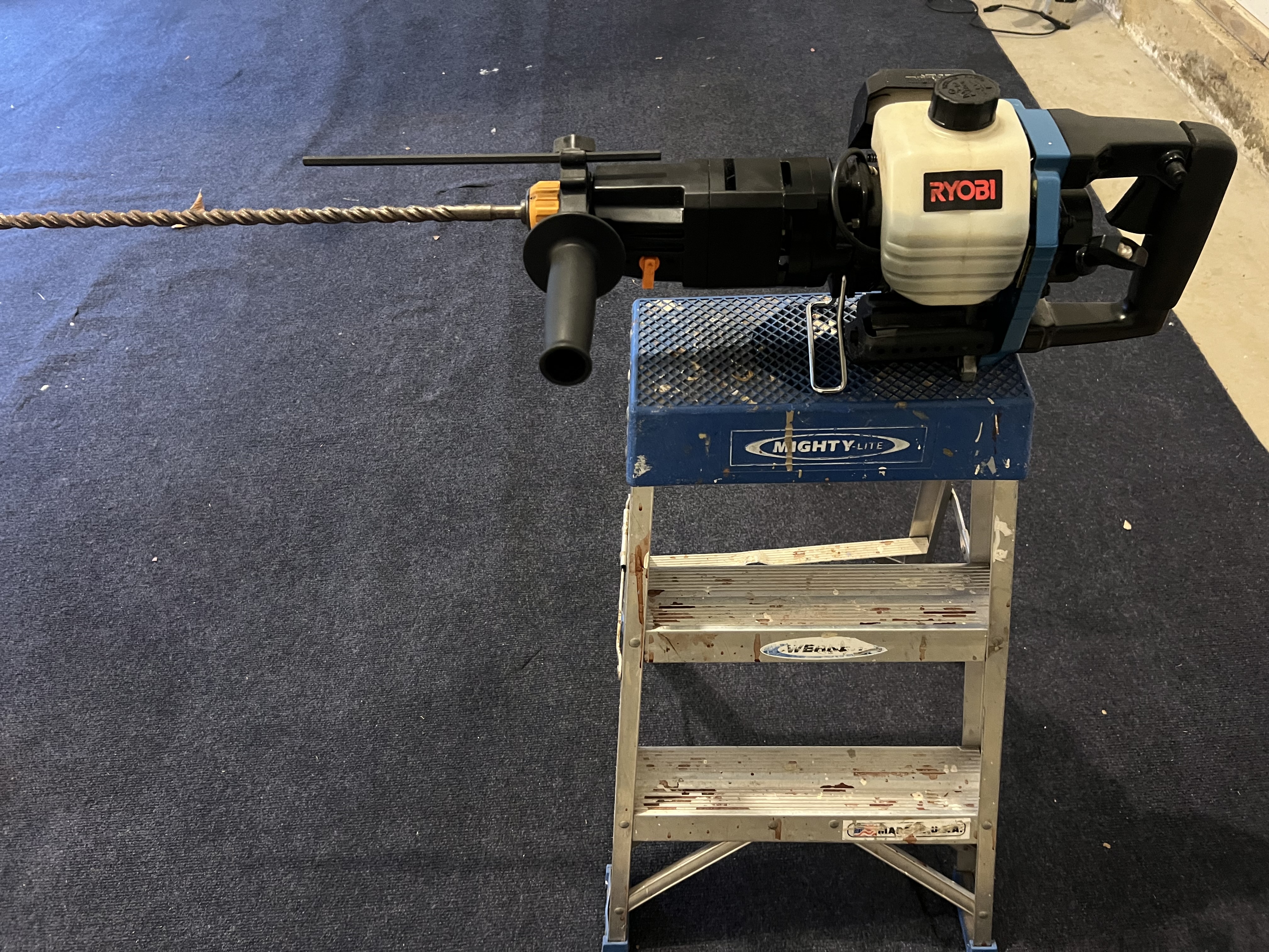

The only time I saw a gas drill used was working on pier pilings.
The helper said using an electric drill while standing in waist high water was not an option…
I imagine now battery drill would substitute?
He was drilling 1 5/8 inch holes for 1 1/2 stainless all thread 20-24 inches through the pilings so Battery might not be better than gas?

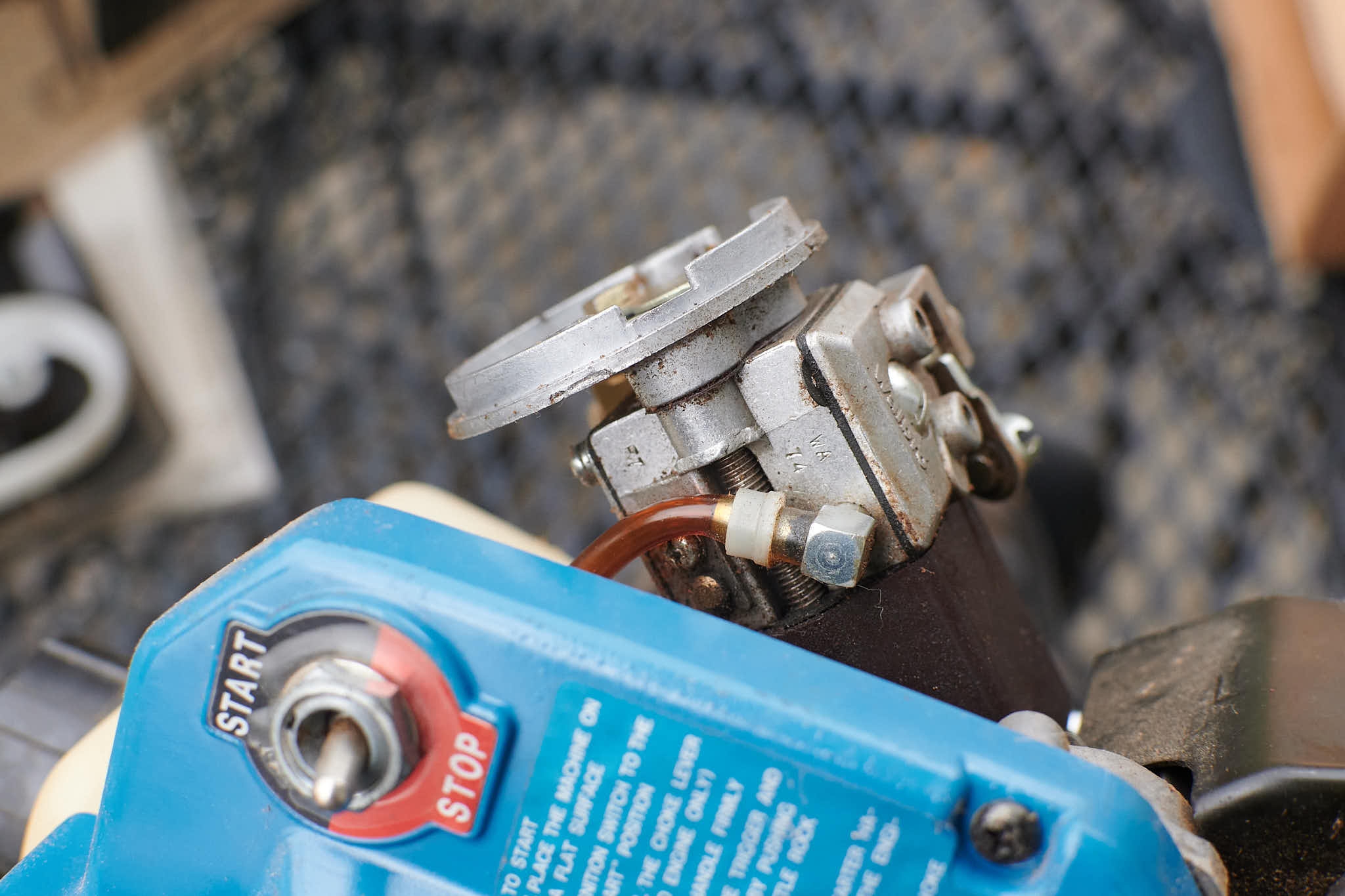

I have one of those recip saws. Give me a little time to get it out and see if I can figure out what carb is on it.
   / Ryobi gasoline powered drill/hammerdrill #25
This is a Ryobi EJ100 gas recip saw I bought in 1992. It has a Walbro WA74 carb with R7 stamped on it. ryobi part no. 2FR66652 with a gasket 2FR66671. Noticed that the two carb air filters are shot on mine, but forgot to write down the part nos.
The specs say it weighs 11lbs and has a 1 inch blade stroke. The box says Ryobi Limited Tokyo Japan. I suspect it was made in Japan because it has that sort of quality feel to it.
For some reason, I am wondering if Ryobi might have also made a third gas tool besides the recip saw and the drill, but it's been a long time. I don't recall these being on the market for long or being advertised that much, but can't say for sure.

I haven't bought any Walbro parts in probably 20 years. While I think you may be able to get parts for the carb itself, I don't know if the air filters can be had. You might have to buy a larger filter and then cut it down to fit the filter housing. I would expect all of the original filters to be shot by now like mine.
