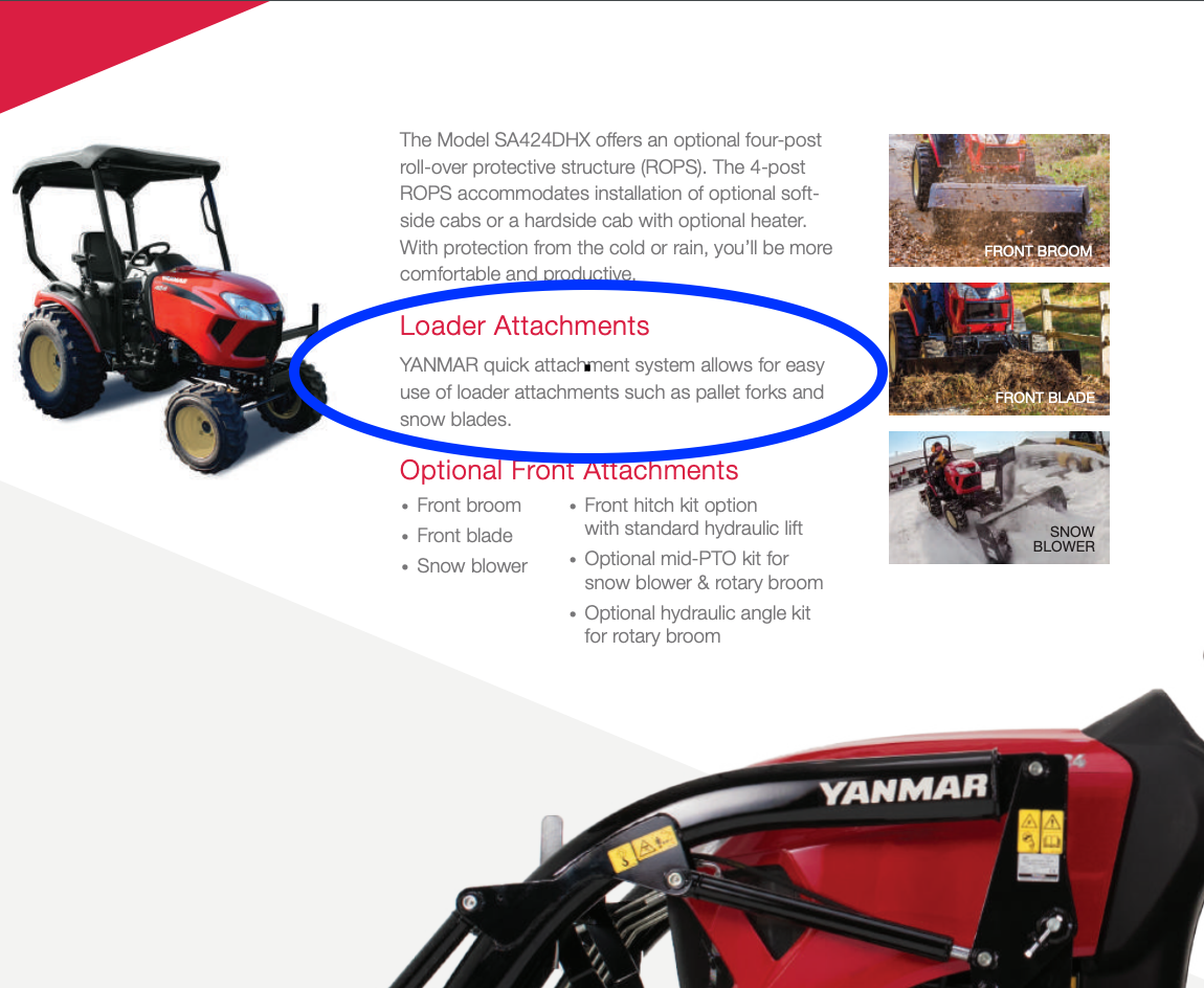

Wow, I didn't realize the SA324/424 doesn't come with skid-steer quick attach. Some of the statements in their advertising imply that it does, like this one attached below. So what exactly do they mean by "YANMAR quick attachment system"? And how long does it take to switch from, say, bucket to pallet forks? Thanks for bringing this up. I've been evaluating the SA324 vs. the new LS MT225S and I did not realize the difference wrt this feature.
/ SA424 with skid steer quick attach #5
It says "Yanmar" quick attach system. They must have their own so you have to buy their attachments. That would certainly be a deal breaker for me. That's why I would never buy a JD either.

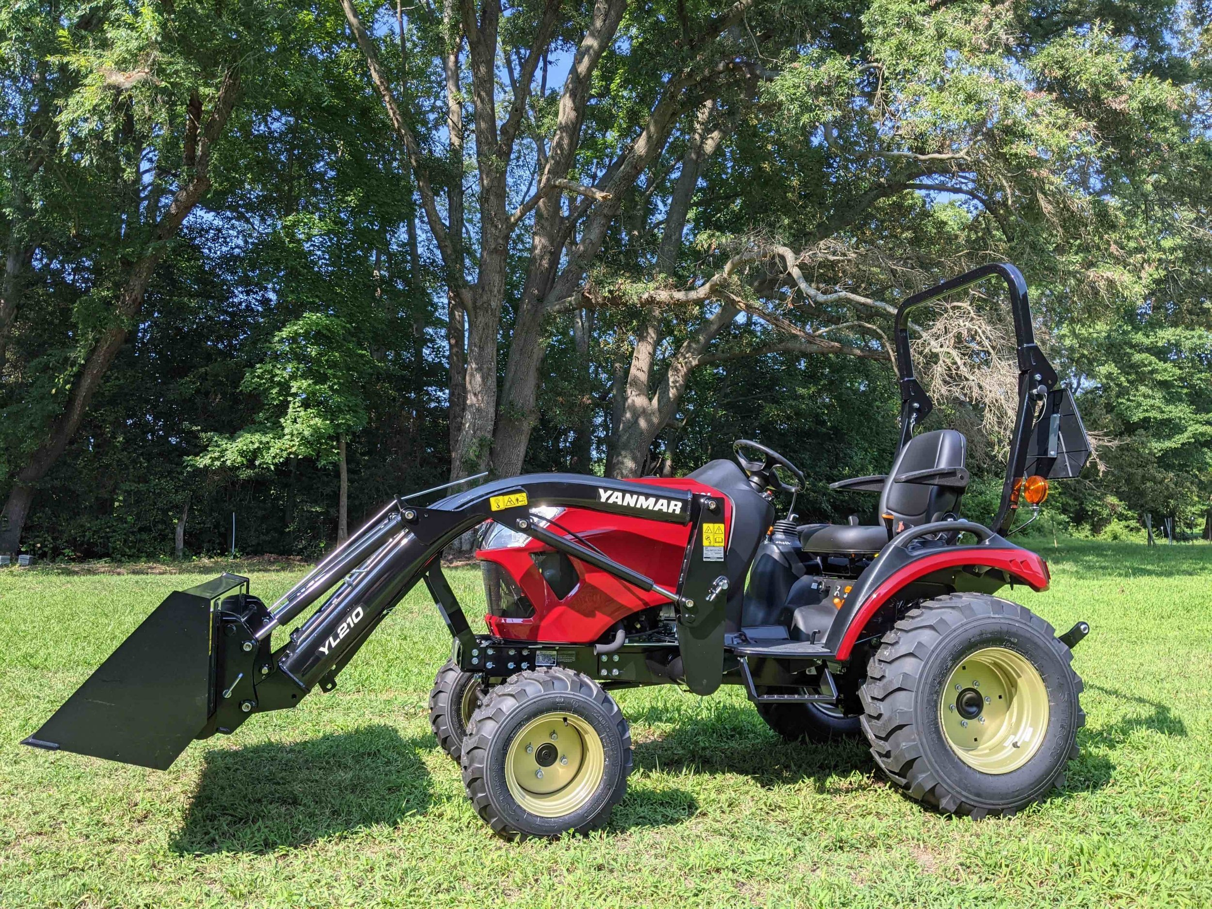

I took delivery of the tractor a few days ago. It took me about ten minutes to get over the HST noise!
/ SA424 with skid steer quick attach #19
Actually... I have a question for you. What is that foot lever I've circled in the attached picture?
Having intimate knowledge of the differential lock linkage on these tractors, that's my off-the-cuff guess. If so, that sure beats the way they used to do it!
