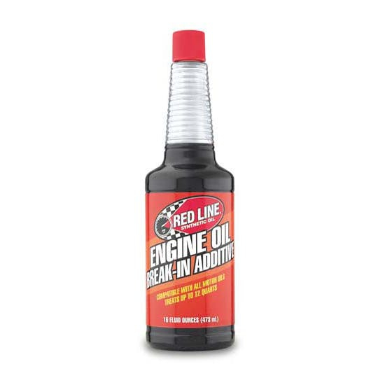

It was a bottle of engine startup lube and I think I used 4 ounces. I would call the company because too much ZDDP is as bad as done. I recall--I think--one bottle did 15 quarts of oil but call and check because I didn't write it down.
EDIT--Uh oh. This is what it was.
It was Redline cam break-in oil. Got the recommendation from a top notch pro builder.
Here's a pic...

Sounds about close to what I thought, I will check before using the lucas.

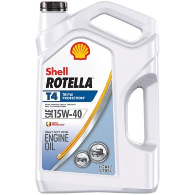

RickB puzlrock said: I would suggest Rotella 15w-40w as it has zinc
It says right on the label HEAVY DUTY DIESEL OIL.
willy

The C123 engine (initially designed in the 1930's) doesn't fit my definition of a modern gasoline engine and doesn't have any features or accessories that might get compromised by a higher viscosity engine oil with diesel oil additives.
And yes, I absolutely did recommend 15w-40 for the OP's Farmall. I have never, ever seen any 15w-40 oil that did not carry a C rating for Diesel engines.
