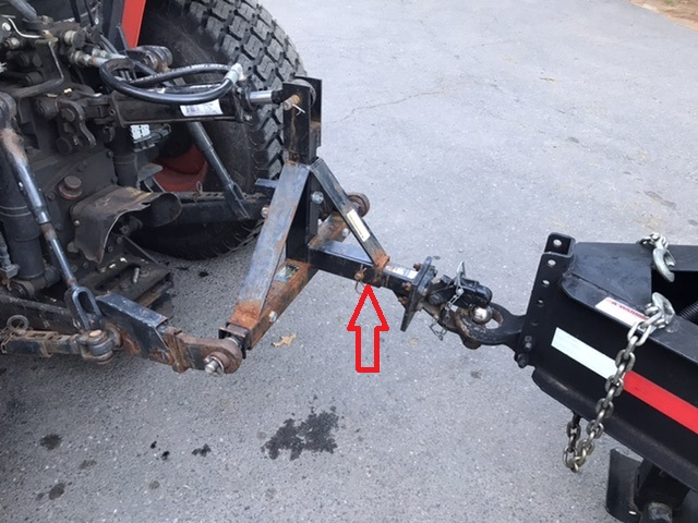

Looking to add a safety chain to my PJ dump trailer tractor combo. I have the trailer hooked to the flex point #FPHS 3 point hitch which makes it easy to hook up and drop the trailer easy from the cab. I only use this setup on my property.
I am looking for ideas on how a safety chain could be safely and easily used with this system. The chains on the dump trailer are too short and would keep those for on road applications with the truck. I am also looking for a good place to buy chain and hooks and not some Chinese garbage.
Thanks for any input

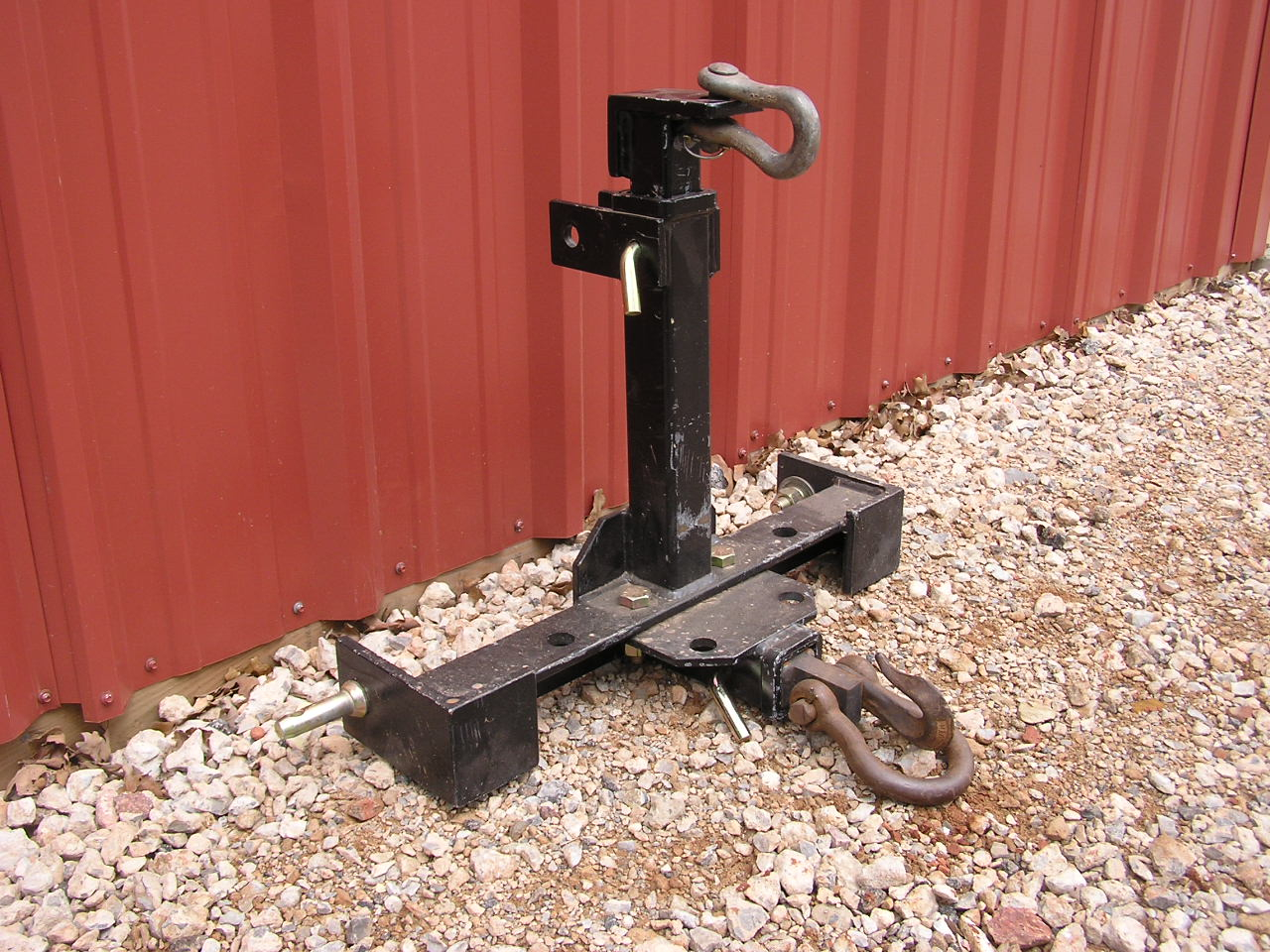

One thing that I would be more concerned about would be the possibility of the trailer tongue lifting up on the drawbar assemble that you have.
I would rig a chain from the lift arms down to a solid location on the lower tractor frame to prevent the hitch from raising higher then the hydraulics can lift it.

the second picture show my stop chains for my trailer hitch.

Replace two of the pintle hook mounting bolts with eye bolts or eye nuts. Hook your road safety chains to them.

I agree with Lou on chaining down your trailer hitch to the drawbar. Even if you're not pulling around that dump trailer loaded with any weight, the trailer by itself can toss it's head freely if you're just using the 3pt trailer hitch alone.

You're thinking of the trailer safety chains. The OP is asking about a chain to keep the 3pt from being forced up by the trailer.

Interesting the ideas about chaining the hitch down on the trailer as well. Never thought about that and have used the setup a few years without issue. Thanks for the idea.

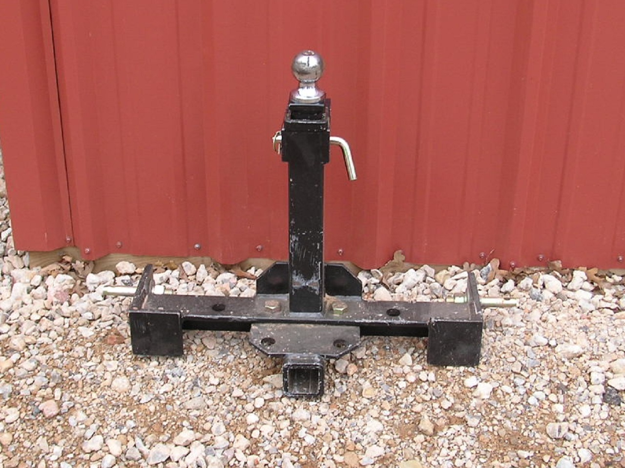

@LouNY I like your setup. Did you make the hitch or buy it?
/ Safety chain ideas needed #12
Built it, it's a multi purpose hitch.
Drawbar (bumper type) or gooseneck and also used for pulling.

For solution to OP first post on trailer safety chains to short, put a set of loops at end of receiver to accommodate "road" chains on trailer....
And YES chaining down 3PH would also be good idea...
And if chains drag, use bungee cord to support them...
IF chains still to short add a few links...
