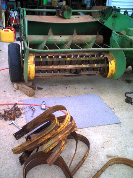

I've been soaking the knotters & chains in penetrating oil along with greasing every zerk I can find..

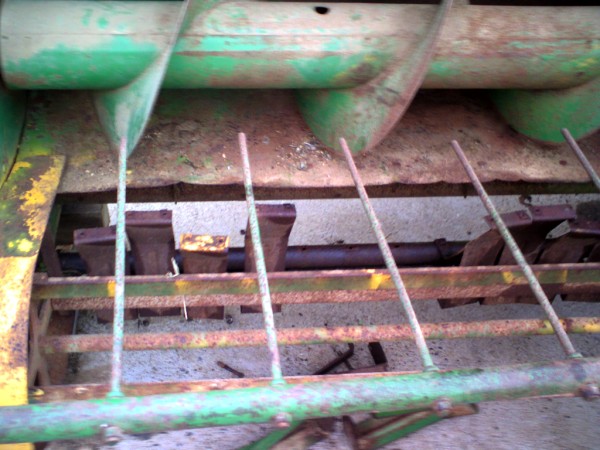

I finally got everything moving by gradually rolling the flywheel back & forth. The knotter gears rolled over & the needles came up & then everything stopped moving. I think there's something stuck in the twine disk area on the right knotter. I'm soaking it in penetrating oil in hopes I can get it to free up so I dont have to take that apart.
While it's soaking in pen oil I decided to disassemble the pickup so I can get the broken springs off & get some painting started.
Some more photos..

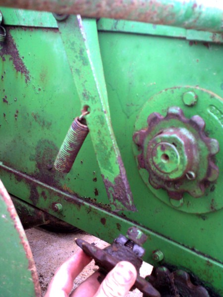

Apparently while rolling the flywheel I got a chain bound up & broke the arm holding the gear on the pickup.. I'll have to fab a new arm but it does not look like it'll be too hard to replace.

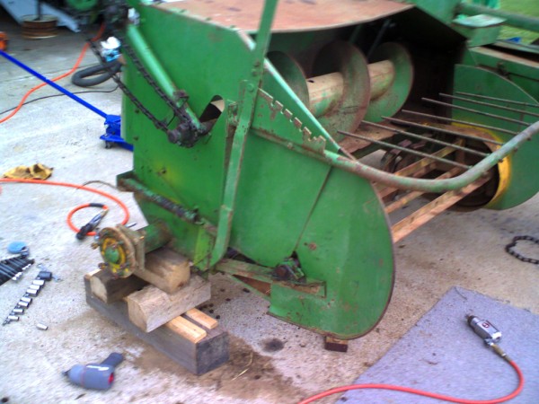

Also pulled off one wheel so I can start working on the bearings & paint the wheel.

The arm that broke is part of the chain tensioner for the pickup. Hope you have a welder. All you need is a$99. AC buzzbox from Craigslist to do it up right. The cause of the failure was the spring that dissolved with age. A few more of those springs are all around this baler. A few under the bale case are for the plinger stop and a few more for the tucker finger retractor. Home Depot or TSC or any local hardware store has them.
I hope you are following the 532 baler fixup that's going on on this Discussion topic. Some good lessons for you there, too !

I looked @ the arm last night & was wondering about welding it.. It looks like it's cast & I've never welded that before.. I have a welder & some nickle rod for cast iron, Is that all that's needed?
I'll look for the 532 thread - thanks for the info.
