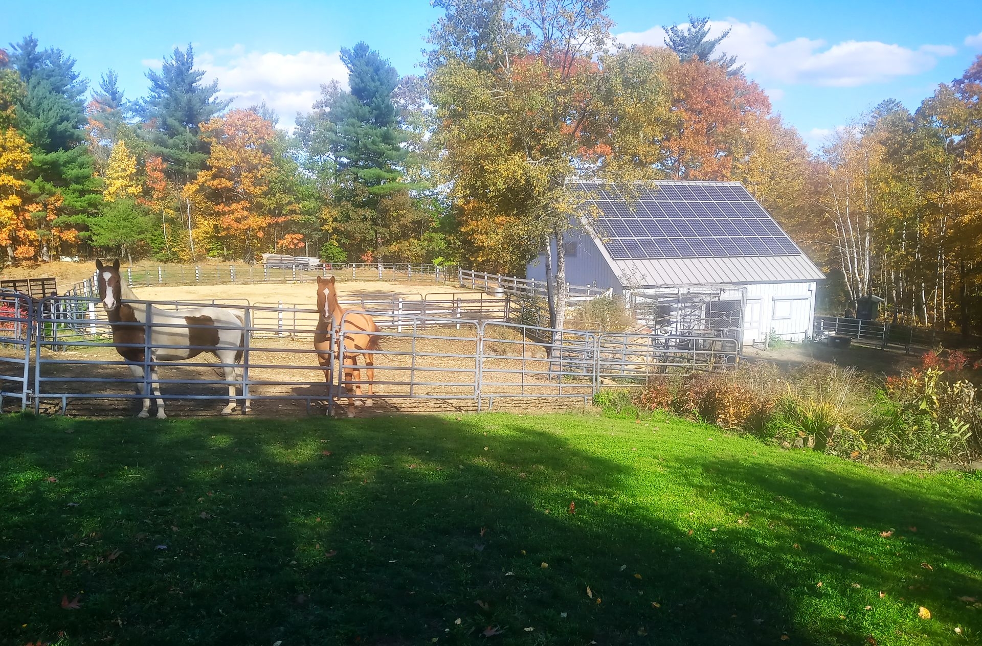

The barn needed a roof. Fed subsidy at the time was 35% State had another $2,500 grant. We needed to refinance the farm. Our electric bill was $800/month during winter to keep water buckets and troughs warm for the criitters. In general we use 3X the juice of a typical household.
For about $30K including a new roof we added 14KW of solar with micro inverters to barn. Our mortgage payment extended another 3 years, but the payment was the same.
Our electric bill is now $400 to $500 during winter while we pay nothing for 2-3 months of year when not running house AC etc. Our water heater and stove is propane and we heat with wood mostly.
We would have never done solar without the incentives and needing barn roof.
Payback will be slow, but it made sense given our circumstances.
