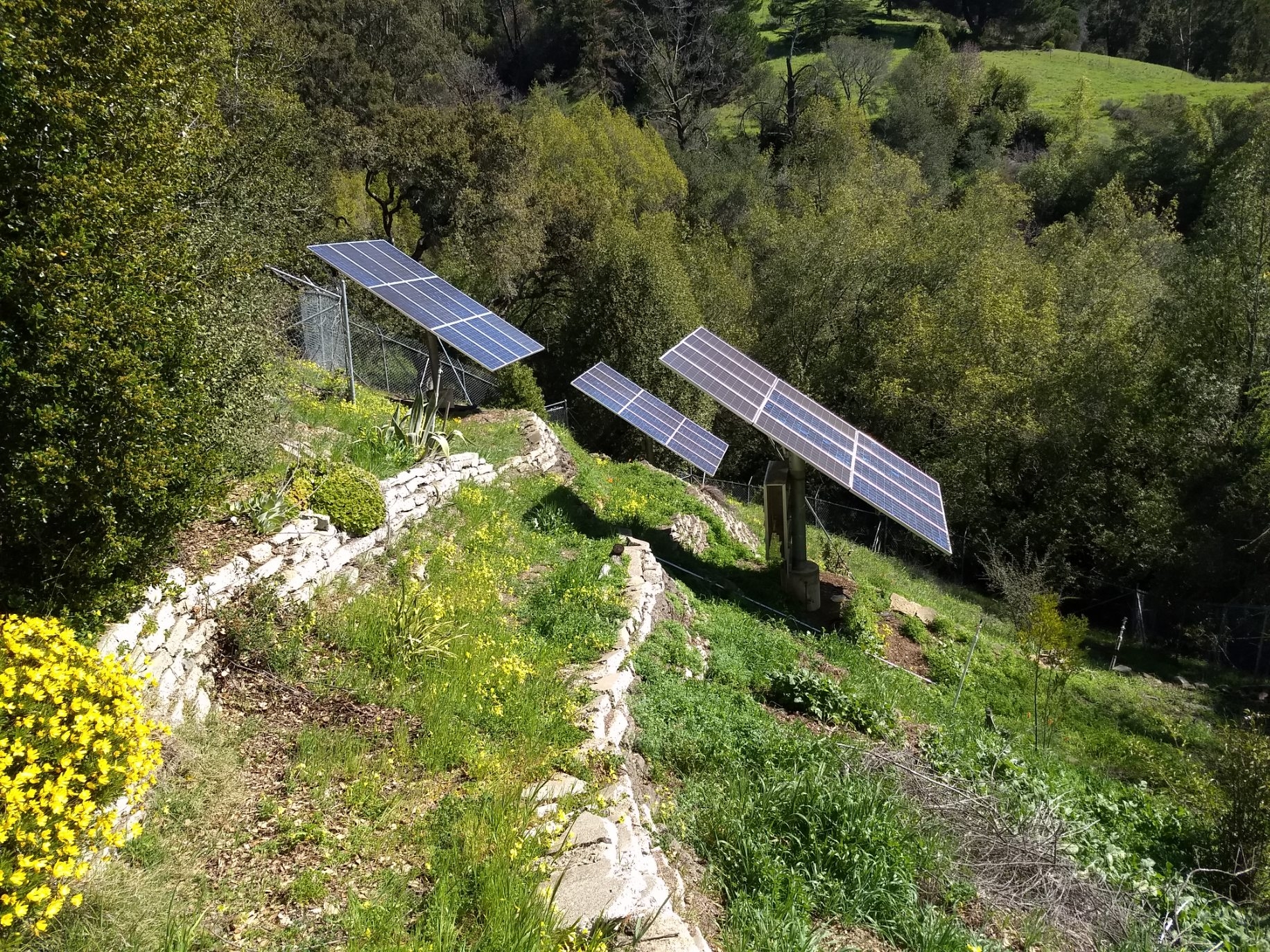

6kW with 160W panels 2008 and SunnyBoy Inverter
Is that picture from your Oakland property or one of your others? If the former, it's a lot different than I pictured it.
Good way to utilize a steep, otherwise minimally useful piece of land.
Yep… the backyard of my Oakland home… picture taken in early Spring… I’m on a saddle ridge with the street running down the center of the ridge and homes on each side of the ridge have lower property line boundary running to the middle of the creek beds.
One picture is looking at my place from across the canyon and second picture is the part of the rear yard that is terraced.
It’s about a mile walk on the paved roads to the home where I grew up here in East Oakland.
About half the distance cutting through the canyon on moms land.
Nice place. I had pictured Oakland as being very urban (and I'm sure some neighborhoods are).
