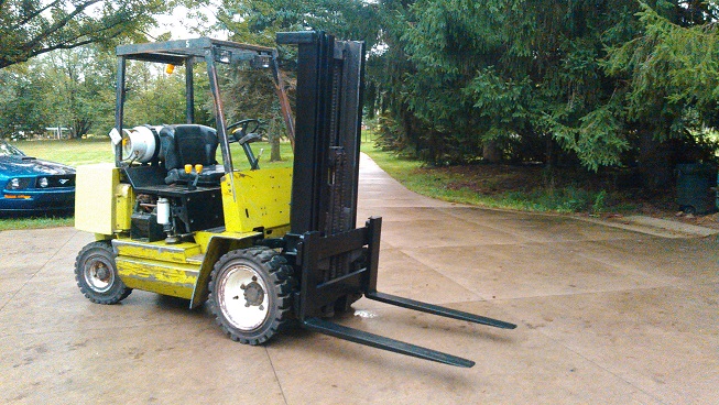

slowly but surely... got all the rust wirewheeled off and ospho'd, went with bedliner for the black...got all the rust/paint/filler off the counterweight and repainted that chunk, painted the rusty floor/seat structure, bushed the levers...found a bad roller on the mast(easy one) and went to start tonight, it ground once- better pull the starter and look at the ring gear/bendix...gotta sand/fill some dents in the side tin, was gonna pull the cage off, but no way to lift, so its gonna have to get rear sheetmetal welded/roll painted as it sits...

got the rest painted, done for now... lights are still off as wiring was a mess, will put back on soon, but everything else is working, running fine...glad its no longer rusting, awaiting a trip to the scrap processor, but again...needed it like a hole in the head :)

That's a mighty fine restoration. I like the multi-stage mast, mine only lifts 11 feet or therebouts, but it's better than no forklift.

thanks, when I saw it was a 90's model, and a triple, just couldnt stand to see it sinking in the ground... honestly, a smaller truck would be better at home, this thing is too tall to get into one garage and weighs 9900, worried it might crack the floor...gonna need to pour a heavy pad/put a lean to on the garage to keep the truck i didnt really need...but heck, getting older, having easier ways to move heavy stuff might be a back saver- i built a big rotisserie out of a gantry crane for my mustang, put it together by myself except had one of the kids on one tractor to help roll it upright(used legs like a 'gin pole' to roll it upright- top beam is >500 pounds alone). that was 5 years ago, doubt my back would tolerate taking it apart now- this thing will make that easy peasy. ever since putting it together, ive been thinking how much harder it was gonna be to roll it down without damaging it... heck even moving the cradles/lift tables I used to hang the car can be be done easier with the truck...the cradles alone were a couple hundred pounds ea...they clamp to 2x2 lift bars, and support the body under full length of the rocker...made them in 2003 to pull the body off our 65 galaxie, but my back was still pretty good back then :)

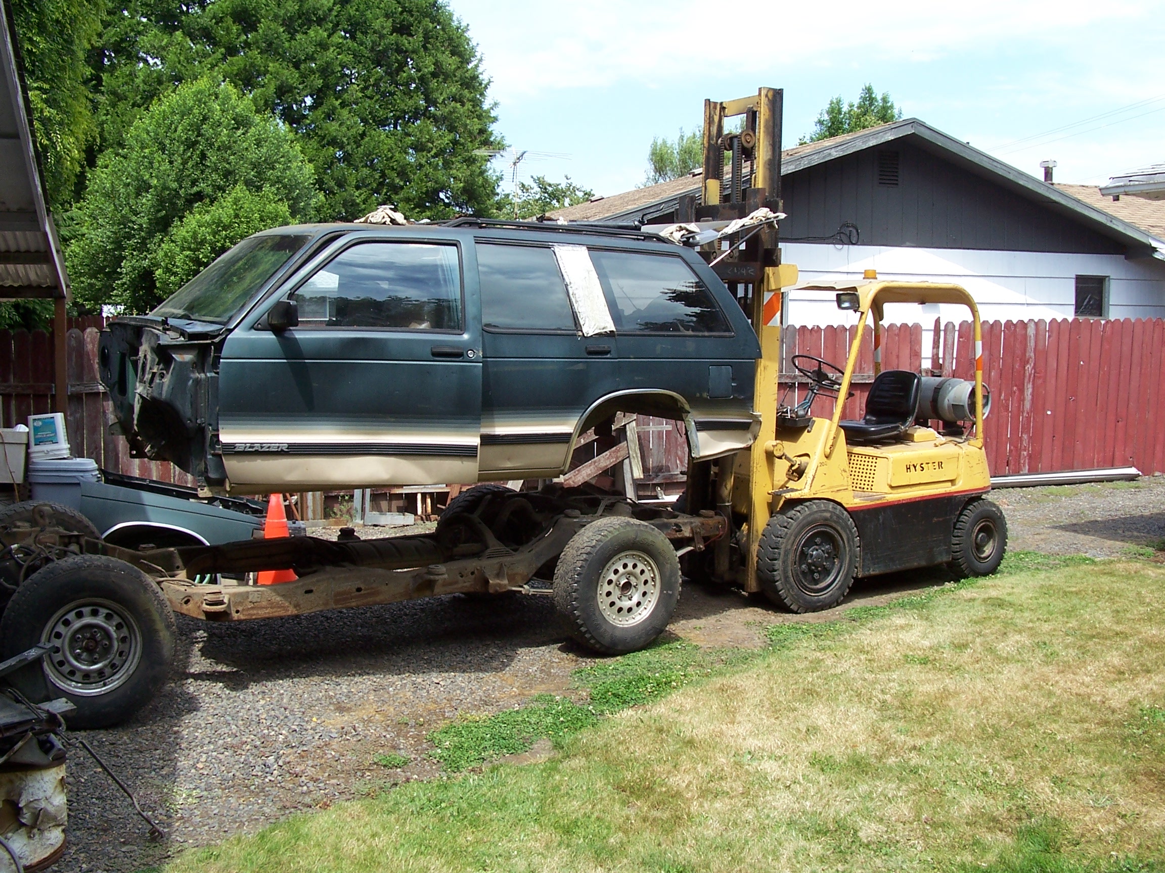

Now you need some extended forks, I lucked into some 4x8 I beams and a chunk of 9" .250" flat bar for $40 and made me some 8 footers. And of course you need one of the baskets for elevated work platforms.
Here's me slinging a Blazer body off, the back window is on and a board with some rugs at the front door openings avoided any damage. Be pretty difficult to do this without long forks.
long forks are great- never thought about pulling a body from behind, lifting by roof, looks like it worked well...

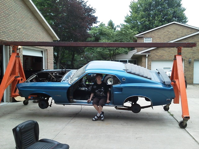

Some people need an app on their phone that stops them from texting when they get drunk. I need an app that stops me from posting before 9am. I'm not a morning person. Sorry for that. You're absolutely right. I see it too, and it's depressing. And you were right before before you changed the wording, too. That's probably why in my morning stupor I took it personally. I don't relate to my generation much. I've always felt like I was born a few decades too late. I get tired of being labelled and lumped in with "millenials" or "x-ennials" or whatever the word of the week might be. We aren't all like that, but most of us are, and it's sad. I share all of older people's gripes with my generation.
But the good news is, if you're young and not afraid to get your hands dirty in 2018, the world can be your oyster! That's literally about all it takes to succeed these days. You don't need to be smart (it helps) or educated (it helps); just be a hard worker and it's like shooting fish in a barrel. You will have very little credible competition in the workforce. My message to (other) young people: ditch the mentalities of victimhood and entitlement, go work hard, learn a skill (that doesn't mean wait around for someone else to teach it to you), and conquer the world! Sorry, you probably won't start out at $20/hr.

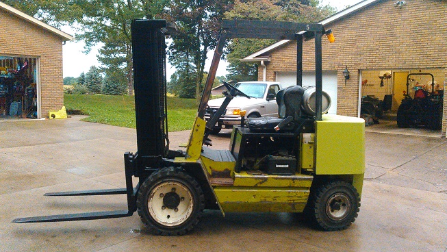

Anyway. Got to get to bed. Up early tomorrow to hopefully finish the panel I'm building so I have time in the evening to crack open these two welders I bought the other day for scrap price and see if I can make at least one good one out of two broken ones.

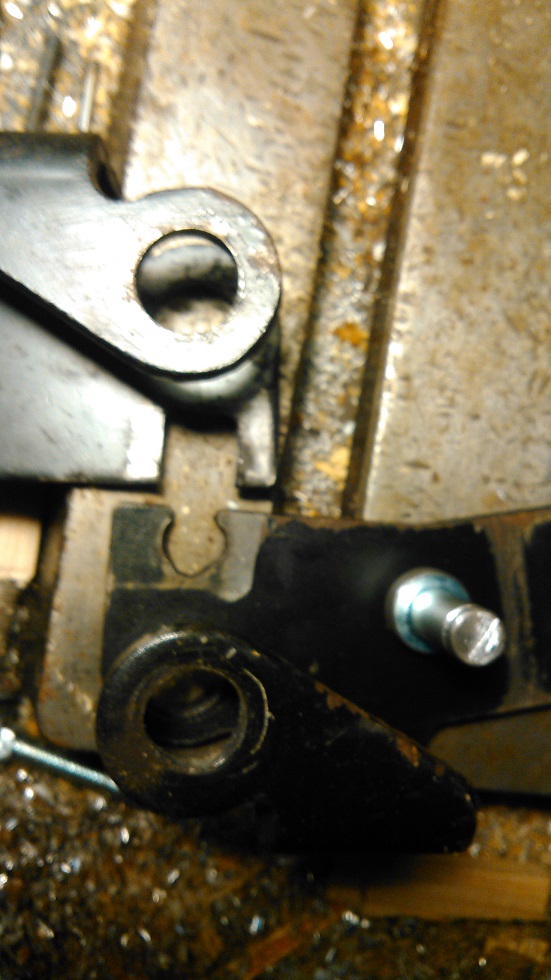

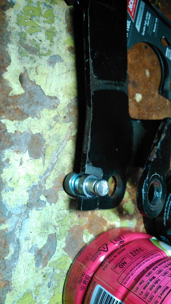

Hey sorry not forklift related but I'm tearing my CNC apart and overhauling it. I found that the X-axis servo (Fanuc) has an alpha encoder. Curious how the last guy made that work, I pulled it apart and found this cute little guy hiding under the red cap. Thought you might find this useful.
