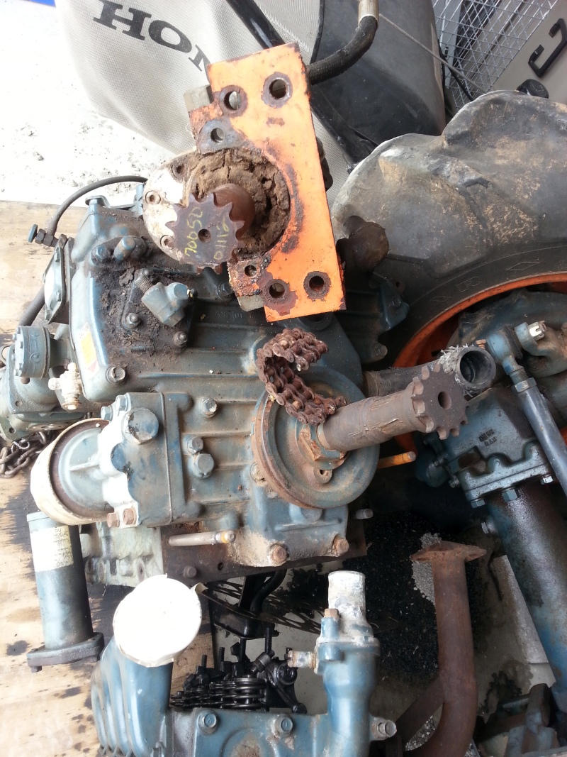

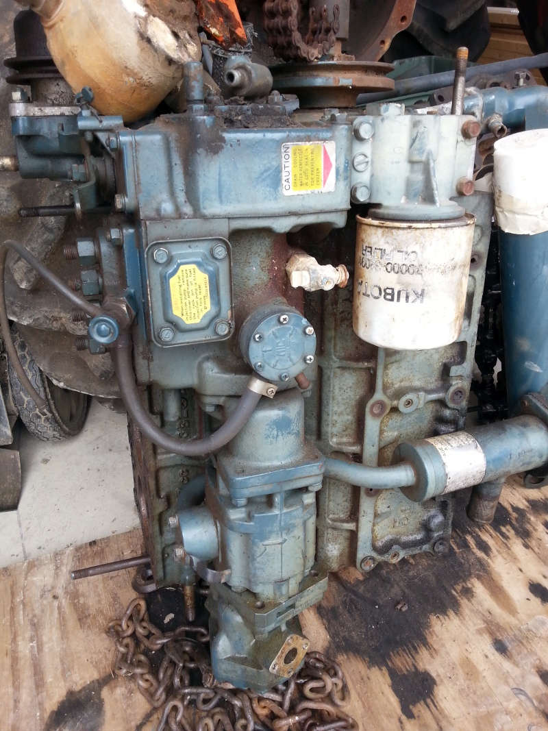

Hi Dick , yes I am confused , and because of that I am going to try not to make any deviations from factory parts in hopes of success with the least amount of problems . The hydraulic pump is mounted with brackets holding it in front of the engine above the front differential , the crankshaft has a long shaft with a sprocket of sorts on the end of it , and the pump is driven with a coupler chain that goes from the sprocket on the crank to the sprocket on the pump , I will post pictures for you , but the crank sprocket's teeth are all worn on one side and leaning or angling over , I will take pics with the brackets and front of engine to hopefully show you what I'm concerned about .

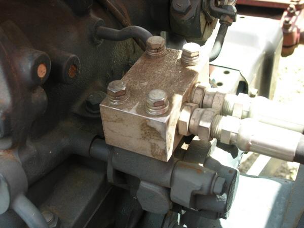

If restoring a front pump drive is not possible, there is another option. The loader can be powered instead from the tractor's internal hydraulic system, eliminating the front pump and side tank (which were options). To do this a 4-bolt cap under the seat is replaced with a port block for connecting the hoses (see pic). The loader is not as fast, but it has the same lifting power.

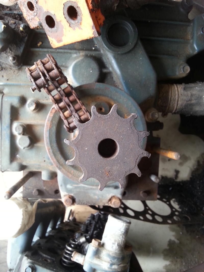

Hi Dick , The extension on the crank seems to be one piece on my tractor but its still in bad shape , for some reason the sprocket on the pump is still in great shape . I am having a heck of a tough time getting the extension off of the crank , I'm going to drill a hole down the center of the extension so I can use a bearing splitter with a puller and be able to push against the end of the crankshaft .
I am curious what that block is plumbed to in your photo , is it bolted down over a port ? I looked at my tractor and can not picture where that block would be placed .
Is the crank shaft driven pump basically a booster pump ? is it increasing the volume as well as pressure ?

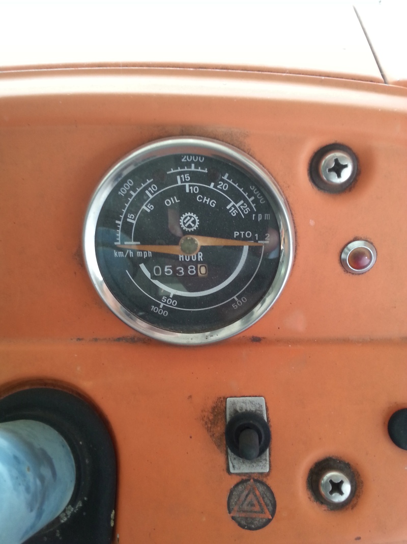

I was sorting parts out today and discovered that all the rods are ruined from the previous owner hammering on the end of the rods with the caps off to get them out of the cylinders , and he really went crazy with beating them to death , the bolts for the caps wont even thread into the rod because the bolt holes are crushed , I sure wish I had noticed that before I got the tractor , I'm almost ready to try a V1702 conversion . The hr. meter stopped at 536 hrs so I have no idea what kind of surprises lay ahead for me
Is there a way to identify what the year is on this tractor ? Thank you..:confused:

I'd say STOP trying to take the sprocket piece off the end of the crankshaft. The spocket is in good enough condition as-is to be used in a chain-type flexible coupling.
BTW your pump drive is only 3 sections, different than on my friend's L355. Yours drives directly off the crank without the first "bushing" section.
The worn sprocket in the picture is still plenty good to turn the pump for a long time. One reason your mating sprocket is in good shape is the torque is relatively low. The teeth are worn away a bit because the micro-rust that forms on the teeth gets shined off when it runs. Unlike a bike chain, the chain wrap doesn't need to pull away as it runs, so it should work fine. Replace the 2-row chain with a new piece and squirt some heavy oil on it occasionally - it will last forever.
The external pump is not a booster system - it is a completely separate additional hydraulic system. The pump turns easy by hand. With the loader assembled and hoses connected an electric drill will turn the pump enough to raise the bucket (empty).
The aluminum port block takes the place of the 4-bolt cap bolted under the left side of the seat. Removing the cap exposes two holes. Oil comes out of one and goes into the other. The port block allows flow to be tapped, going out to a valve and back, powering another use (like a loader).
Regarding the engine parts, I'd talk to Scott at Maine Tractor Crossing (207) 834-1164. They list L345 engine parts, including block, connecting rods, head, etc. Might be a good way to make yours whole again, buying just what it needs.

Thank you . I had hopes of removing the sprocket so I could remove the crank shaft for the purpose of getting the engine magnafluxed , but maybe I shouldn't be too concerned about it , all the water jacket plugs are still looking looking good . Thanks for the phone number , I will call as soon as I finish measuring the bores for roundness and taper , if the block needs boring I will still need to address the crankshaft removal issues . Maybe If I have too I can remove the crank and front cover together ? hopefully it won't come to that . Thanks .
