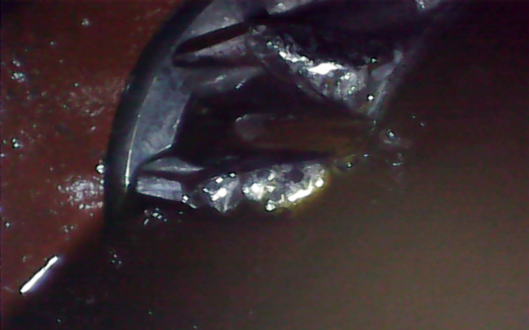

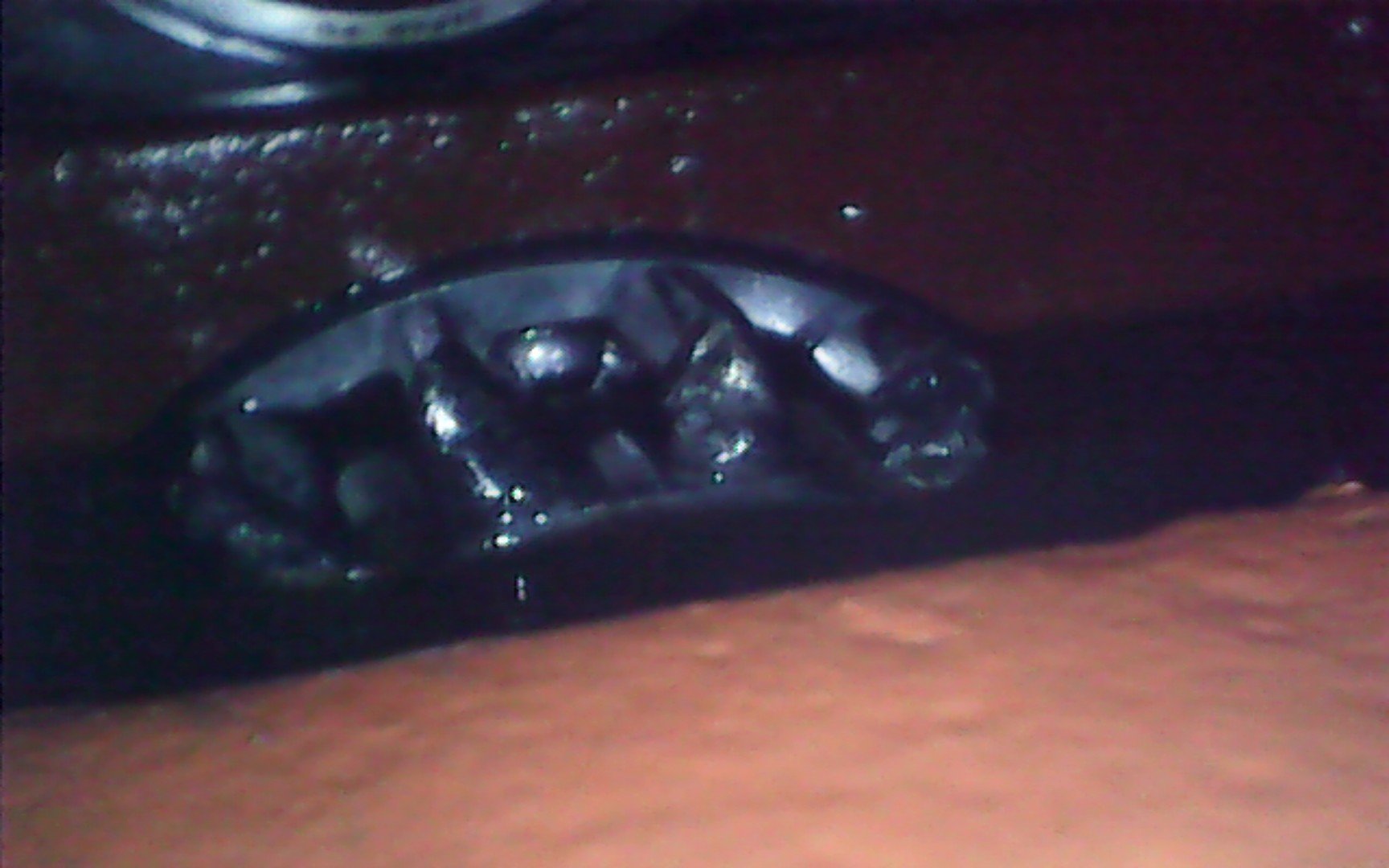

I'd suggest starting a new thread for this something like "L345DT damaged rear pto gear(s)" That should get more eyes on it.
Is the tractor apart now? Which gear? any pics? Might be helpful to add some details like when and how the damage happened - does it still work? is there noise? are both pto speeds effected? I broke mine years ago using a rotary mower. One gear had broken out teeth and two more had cracks. Best luck, Dick B
No I haven't broke the tractor down yet, it's the gear (don't have a part # yet, waiting on the paper shop manual) for the 540rpm pto, yes I have pictures using a scope camra it "broke" involving a Bush hog, it still works in the low pto gear with horrible noises and it keeps kicking out of gear, works fine in high PTO range with no noises or issues.....this is what I have seen so far 2017-08-30-18-46-24.jpg2017-08-30-18-45-58.jpg
