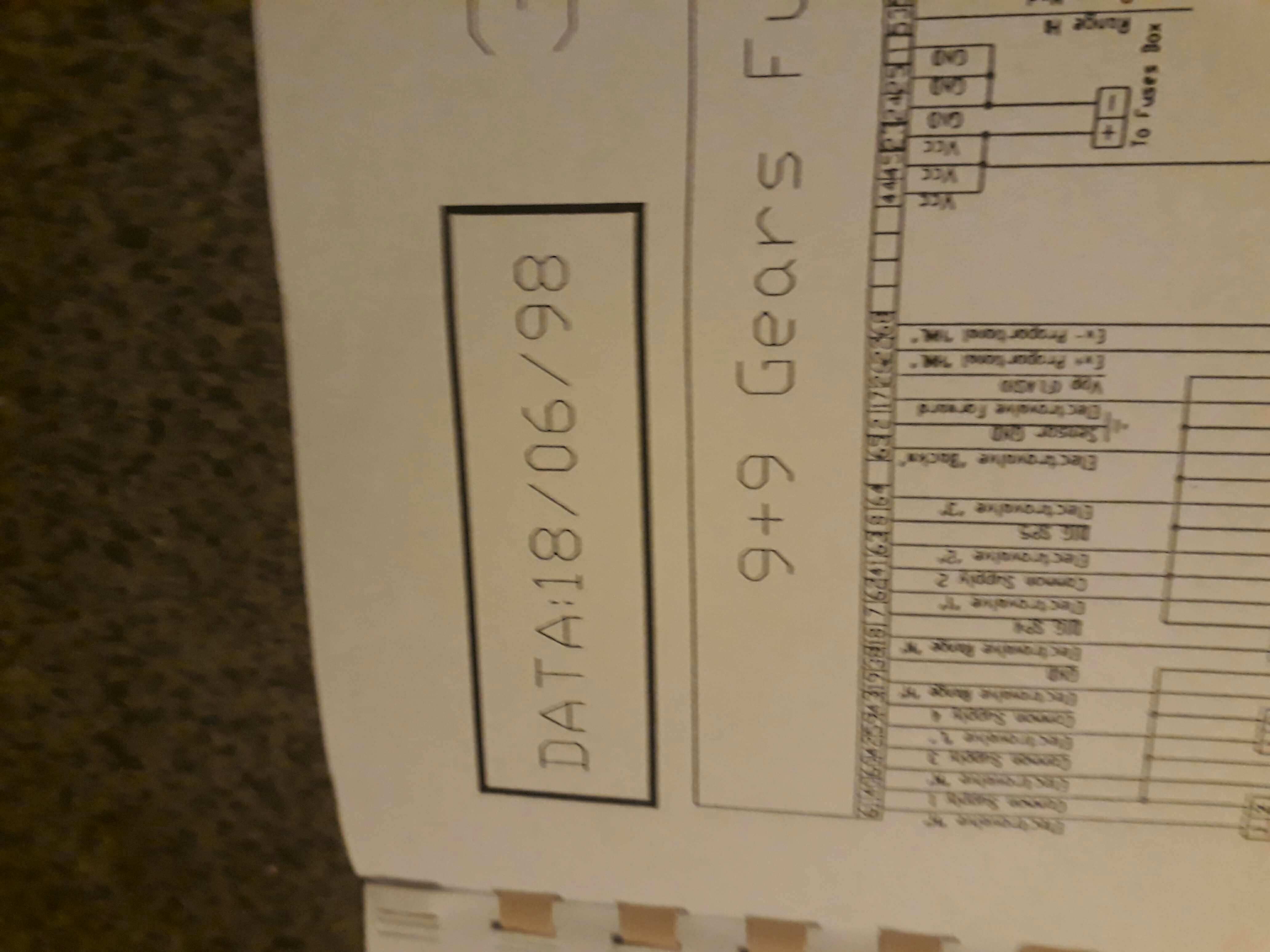

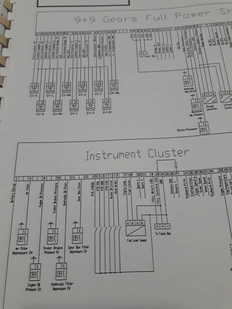

The more I look at the pictures you sent, is that ECU print for the HML power shift or the forward/reverse shuttle? My machine has a 5 speed gear box with a clutch button on 5-speed gear shifter. It has a range shifter then with 4 ranges. It then has the forward/reverse shuttle control on steering column. Would my machine be considered a 9+9 or a 20+20 machine. Regardless, I wouldn't think the forward/reverse shuttle ECU would care how many speeds and ranges machine has.
You have been the most amount of help I've found and we can't thank you enough. Would it be possible for you to retake two pictures, the following two I'm having a hard time reading pin/wire numbers on the first part of the diagram.

will make a copy at the nearest shop and send you the big page

Yes, I agree that is probably something simple. Problem is that with no print for the shuttle ECU it's really hard to troubleshoot.

Since I am able to power solenoids using my jumper wires and force tractor to move I think all hard parts are working? I think you are correct that one of the sensors are not grounding to satisfy ECU. I have Deutz distribution here in States trying to pull a manual for a SILVER 110-130 and the LAMB Champ 120-135-150 manual. Do you have the parts breakdown for the LAMB? If so do that model us the ECU #0.010.6393.4/20.
Sorry I met to say ECU #0.011.3818.4/30 the #0.010.6393.4/20 is for the shuttle (forward/reverse) control lever.
