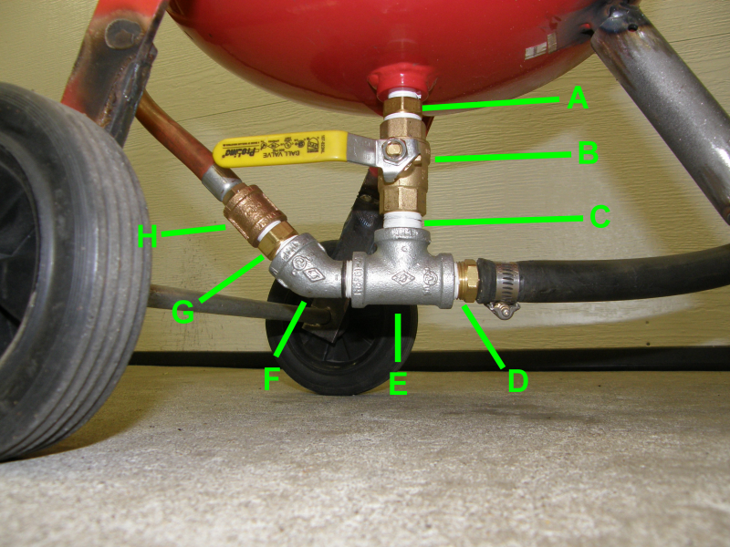

I have a bunch of restoration projects to do on various painted parts of my tractors, Skidsteer, attachments, other tools, etc. I have done limited sand blasting on small parts in the past with the little "suction bucket" cheapo sand blasters (HF still sells one of these). I plan to buy a decent sized pressure pot sandblasting rig from HF. I have an abrasives supplier nearby that sells a wide variety of all the specialty blasting abrasives including soda, and they are good with advice on which to use for which application, and the stuff is not terribly expensive. One of the questions I have is what psi and cfm do you guys that have lots of blasting experience think I will need to use to efficiently blast off old paint and rust? I've used my regular 30 gallon, 5 horsepower, single-cylinder compressor at 100psi in the past. Not sure what the CFM of that compressor is. With the little suction pot blasters, it's pretty slow going. Clearly not enough CFM. So if I go out to buy a new compressor to max out my sandblasting ability, what CFM am I looking for?

You'll need to make some modifications to the HF sandblaster.
The bottom tank valve is famous for clogging up. It needs to be replaced with some larger pipe and valve.
The POS nozzle valve that comes with the HF sandblaster will need replacement also. I bought a Northern Tool deadman style for mine.
See this web site, I borrowed the photo from there.
HF pressure sandblaster modification - Hot Rod Forum : Hotrodders Bulletin Board
Get as much air compressor as you can afford.
You also need a good redundant dryer, I just use two filter/water separator combos in series.
For reusing blast media get one of these to sift the trash out of the media.
I even sift new media, you'd be surprised at some of the oversize particles in it.
Abrasive Strainer | Cabinet Accessories| Northern Tool + Equipment
Northern Industrial Abrasive Blaster Deadman II | Guns Valves| Northern Tool + Equipment
