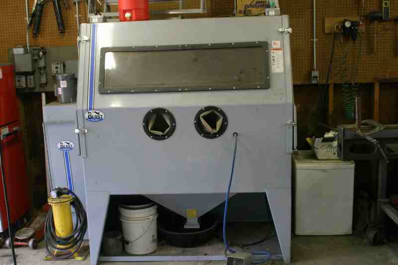

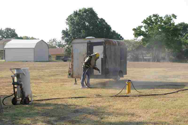

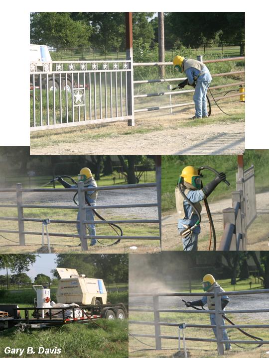

I started out with a 2HP/20gal single stage air compressor and cheap suction sandblaster. Then I moved up to a 5HP/80gal two stage and a home made pressure sandblaster. Then I purchased a TIP sandblast cabinet for $2400. Then I bought a Schmidt 350# pressure fed sandblaster with a Bullard air fed helmet. Got a good deal off ebay at $1600 on that setup. I ran it with a old worn out 100cfm Ingersol-Rand rotary screw air compressor that I had about $1500 into it. Then I bought a 175cfm diesel rotary screw air compressor to fully drive the Schmidt sandblaster. That was another $1300, but a really good deal. I still need to buy the high volume gun for my TIP cabinet, but I think I've reached the end of my sandblasting equipment endeavor. Watch out or you may end up like me.
Unfortunately, efficient sandblasting requires a big air compressor and you will have to put up some heavy coin to get the right equipment.
If you are only planning to sandblast small items, a cabinet is the way to go. My 5HP/80gal/2-stage air compressor keeps up with my sandblast cabinet (although just barely) and that is what I recommend if you don't need to do car frames, fences, etc.
