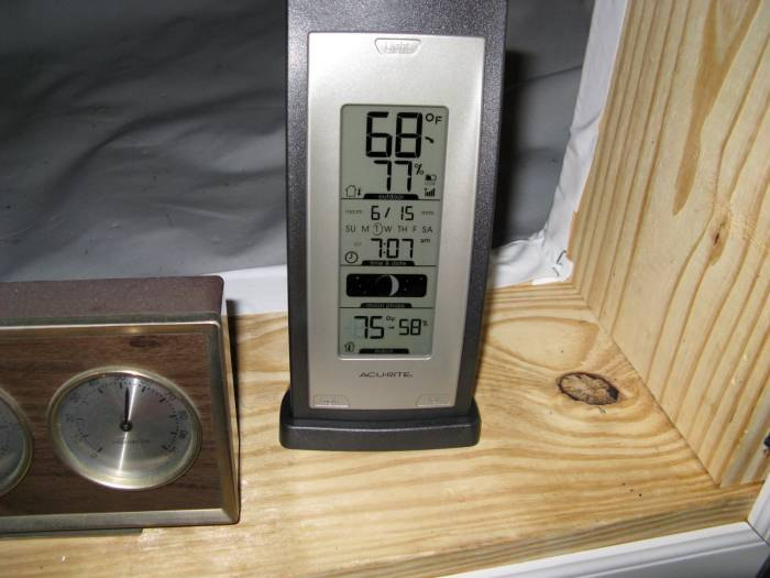

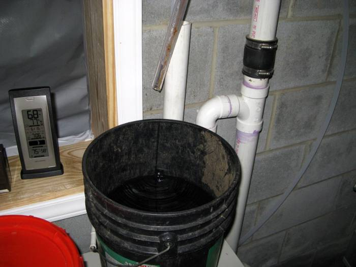

Think this 2nd Santa Fe is short some refrigerant. Here's all the water it made in 24 hours of operation at 75 F and 58% humidity in the crawl space. This is 3 to 3.5 gallons. Supposed to make 8.75 gallons/day. The first Santa Fe did well for 9 months and then ran out of refrigerant sometime in May.
Waiting to see what the company is going to do now. Told them that I did not want to go to a 3rd unit. Hoping for money back. Will go with an Aprilaire unit.
For those of you who posted about humidity in the rest of the house: the 2 heat pumps have temperature and humidity set points. Upstairs is set at 76 F for when we're asleep and about 50% humidity. Think main heat pump has similar set points.
