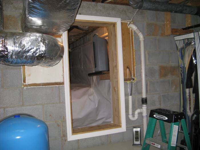

Lost the refrigerant. They're sending a new one. Need some ideas on how to get the heavy old one out and new one in. Near 70 #. We did enlarge the crawl space. Otherwise, I simply could not even get in there myself. It is located about 20 ft inside. There's a big dig just inside before the earth rises up to about a 1/3 way up to that entry hole.
Wife is thinking some 2bys to slide it on. What do WE get on to hold it and slide it? I'm thinking a movable thing carrying a little crane, like a garage door track. To put this one in, my wife and our friend a handyman got it in there. He is no longer available.

carpet to slide on and block/tackle to lower/raise using a tripod if you have the room ?
