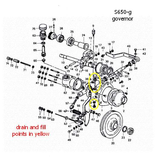

Hey Guys, what do you recommend for oil in the 650g governor? If I'm reading the manual correctly it says 40w. Anyone have any suggestions in changing the 650g governor oil and refilling ? I'm not real sure about the drain plug or fill plug yet........
Any advice is much appreciated.....
Book says to use the same oil as engine. Replace every 100 hrs. Fill quantity spec at 40cc. I use a syringe for mine and it takes 50ml. Image will locate fill and drain for you.Click on it to enlarge. governor.jpg
