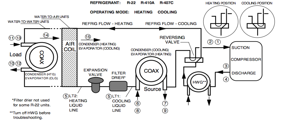

If you don't understand how the heat works, you probably don't understand correctly how the cooling works.
Its not as simple as circulating ground water through it and using that cool water to cool the house, if that's what you were thinking.
There is refrigerant just the same as an air to air heat pump, or your fridge and freezer.
Operates off the same principal.
But rather than use a variable outdoor air temp for the medium to heat/cool the refrigerant.....it uses ground water.
So basically....when heating.....your compressor compresses freon.....which makes it get hot.....let's say 150 degrees but it started out at 50. So it gained 100 degrees by compressing it.
Now we circulate that through the furnace and blow air over it, this air is warmed and heats your house. Cooks the freon down to say 100 degrees. But remember it's still compressed.
So when we uncompress we have to loose that 100 degrees. So now the freon in zero.
Up to this point, a convention air to air, and Geo are the same.
On a Geo, from this point, we use 50 degree ground water to warm the freon back up to 50, and start all over. This cools the water... Which circulates back through thousands of feet of pipe in the ground, to warm it back up.
On an air to air....that 0 degree freon circulates through the outdoor unit, and blows outside air across it to warm that zero degree freon back to whatever the outside temp is. Which is why the colder it is outside, the less efficient an air to air is. Where as Geo efficiency remains as constant as the ground temp is at the 6' depth the loops are burried.
Air conditioning is just the opposite. Compressor still compresses and heats freon. But is either cooled by the outside air on an air to air, or cooled by the ground water first. Then when uncompressed and super cooled, it's circulated through the heat exchanger that the fan blows across, blowing cold air out your vents
There are a couple key aspects to add -- first is that a reversing valve is used to change the direction of the system between heating and cooling cycles. The reversing valve is an important feature. Here's a schematic of my geo system that shows the whole concept pretty well:
Note that the direction of flow from the compressor differs in heating and cooling mode. The other key component is the expansion valve, which cools off the refrigerant (compression heats it, expansion cools it).
In the abstract, the way to think about both the heating cooling cycles is that the refrigerant and machinery is a way to transport thermal energy (aka "heat") from one place (inside the house) to the other place (ground loop). In heating mode, we are actually removing "cold" heat energy from inside the home and rejecting it to the ground loop. So you actually end up cooling the ground loop when the system is in heat mode. In cooling mode, we are removing "warm" heat energy from the home and rejecting it to the ground loop. So you warm the ground loop in cooling mode.
