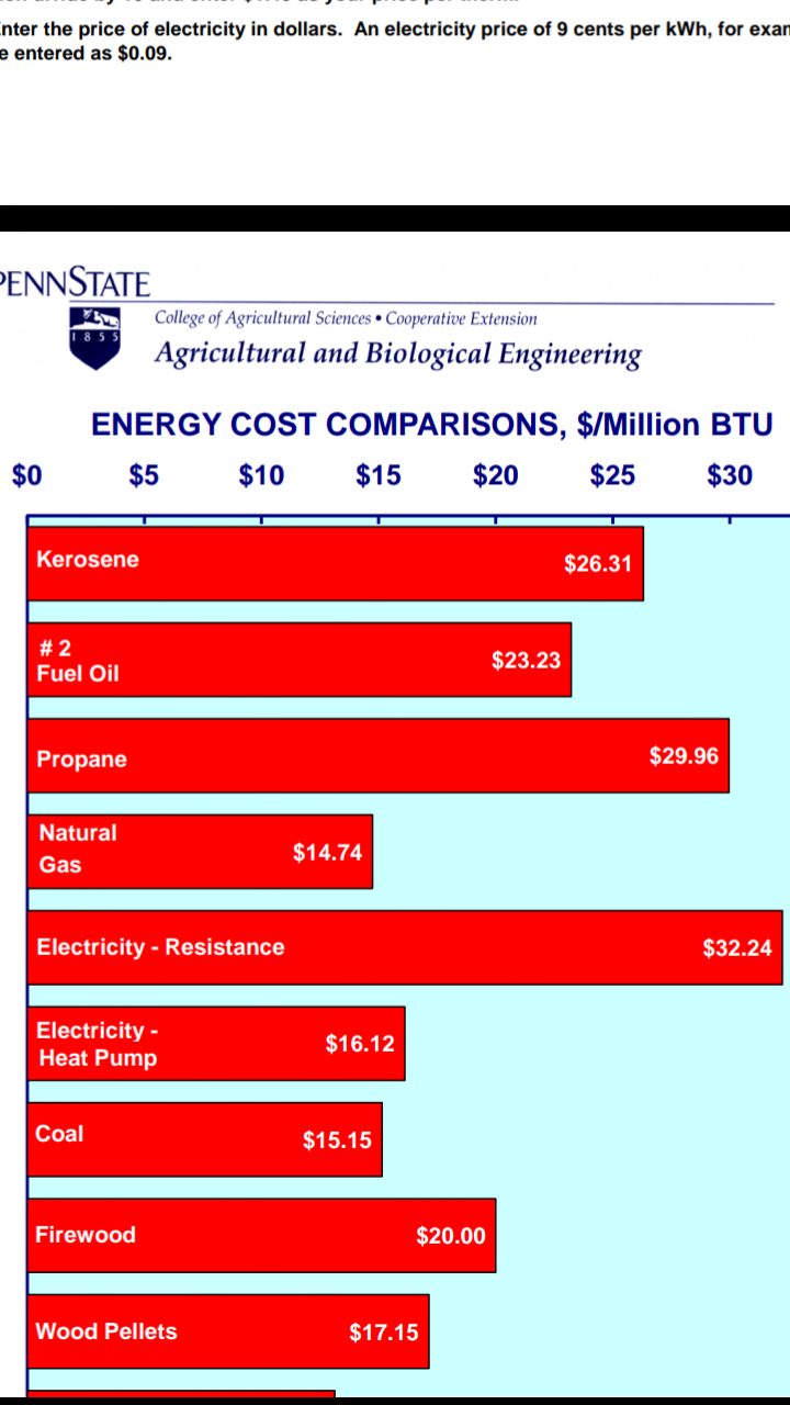

I don't know where they got that chart but it doesn't accurately reflect local prices.

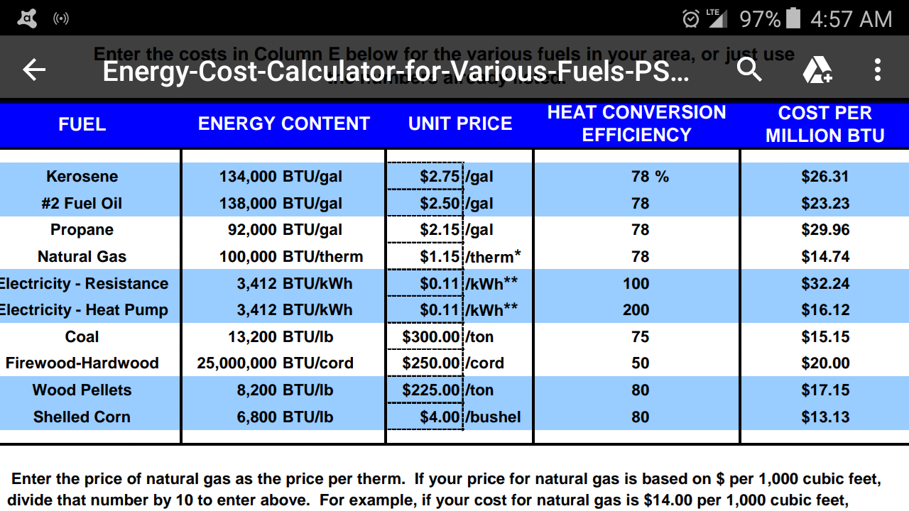

Just pulling some google numbers I get $10 per million BTUs in pellets ( $3.20 a bag on rural kings website and claimed 8,250 btus a pound). I got firewood to be $6.50 a million btus. ( $150 a cord, 24 million btus a cord ) Diesel is about $14 dollars a million btus assuming $2 a gallon. locally kerosene is priced uneconomical for heating. Fuel oil is a non existent fuel source. Propane is used only when natural gas isn't available. Electric is 12 cents a KWH. I doubt the pellets are nearly that high of btus as that's only 300 pounds of pellets to equal a cord of wood
   / Save $$$ - Heat with Wood #174
Just pulling some google numbers I get $10 per million BTUs in pellets ( $3.20 a bag on rural kings website and claimed 8,250 btus a pound). I got firewood to be $6.50 a million btus. ( $150 a cord, 24 million btus a cord ) locally kerosene is priced uneconomical for heating. Fuel oil is a non existent fuel source. Propane is used only when natural gas isn't available. Electric is 12 cents a KWH. I doubt the pellets are nearly that high of btus as that's only 300 pounds of pellets to equal a cord of wood
Missing a zero there.
3000 x 8250 = 24.75 million BTU
forgetting efficiency with the firewood too.
Sure, some modern stoves may be more efficient, air-tight catalytic burn, etc.
But most run of the mill wood stoves are 50%.
So 24M btu's in a cord/.....only 12 million goes into the house as heat (the rest up the chimney).
So $150/cord / 12 = $12.50 per million.
They are figuring pellets at 80% efficient burn. Dont know the cost of pellets, I'll trust their ~$17 per million BTU's is correct.
Their heat pump factor being only twice as efficient as electric resistance is low I think.
Most modern 2-stage (or variable) air to air units are 3:1. And a 2-stage geo closer to 4:1
So by their chart and $0.11/kwh (which is pretty close to what I pay), My geo is in the ballpark of $8/million BTU. Compared to firewood at ~$12. Which seems to fall inline with my real world experience heating the house for two years with wood, and now on my second year with the geo

I knew I left out efficiency of the firewood. I don't know if it was already factored in either. I also left out the fact that there's no local Rural King and you'll have to pay tax and likely shipping on your pallet of pellets. I don't know how you'd go about making a chart with any degree of accuracy. Especially if you post it on the internet because that blows any chance of it because of local cost.
