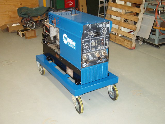

My boss was going to junk this. A few hours of repairing some loose & corroded wiring it was running fine, and I have a nice portable to go along with the DialArc 250.
Then I had to paint it up a bit:thumbsup:

The repair shop wanted $3,500.00 for a new engine:confused: That is why they got rid of the machine. The engine was fine once I got constant juice to the coil.
Along with that the trailer this was on lost a wheel and it rolled on the highway. Insurance paid for that repair but they did not fix all the damage inside. We had trouble with it since it rolled. It has about 1600 hours.

Ouch! I've got a salvaged Bobcat 225 that had an Onan 16 on it I think it was a P220 as well. Onan parts are higher than a cat's back and few around when I was looking. It's still sitting in the shop "engineless". I thought about retrofitting it with another brand but lost the interest. I'm not even sure if the generator will even work once I get it going.:(
/ Saved from the scrap
What is wrong with the engine??

Made a deal with the boss when I got it:thumbsup: I told him if I could fix it it would be available if we need an extra welder.:cool:

Well, here is the next step in the salvage business:thumbsup:
Of course it still needs some paint;)
