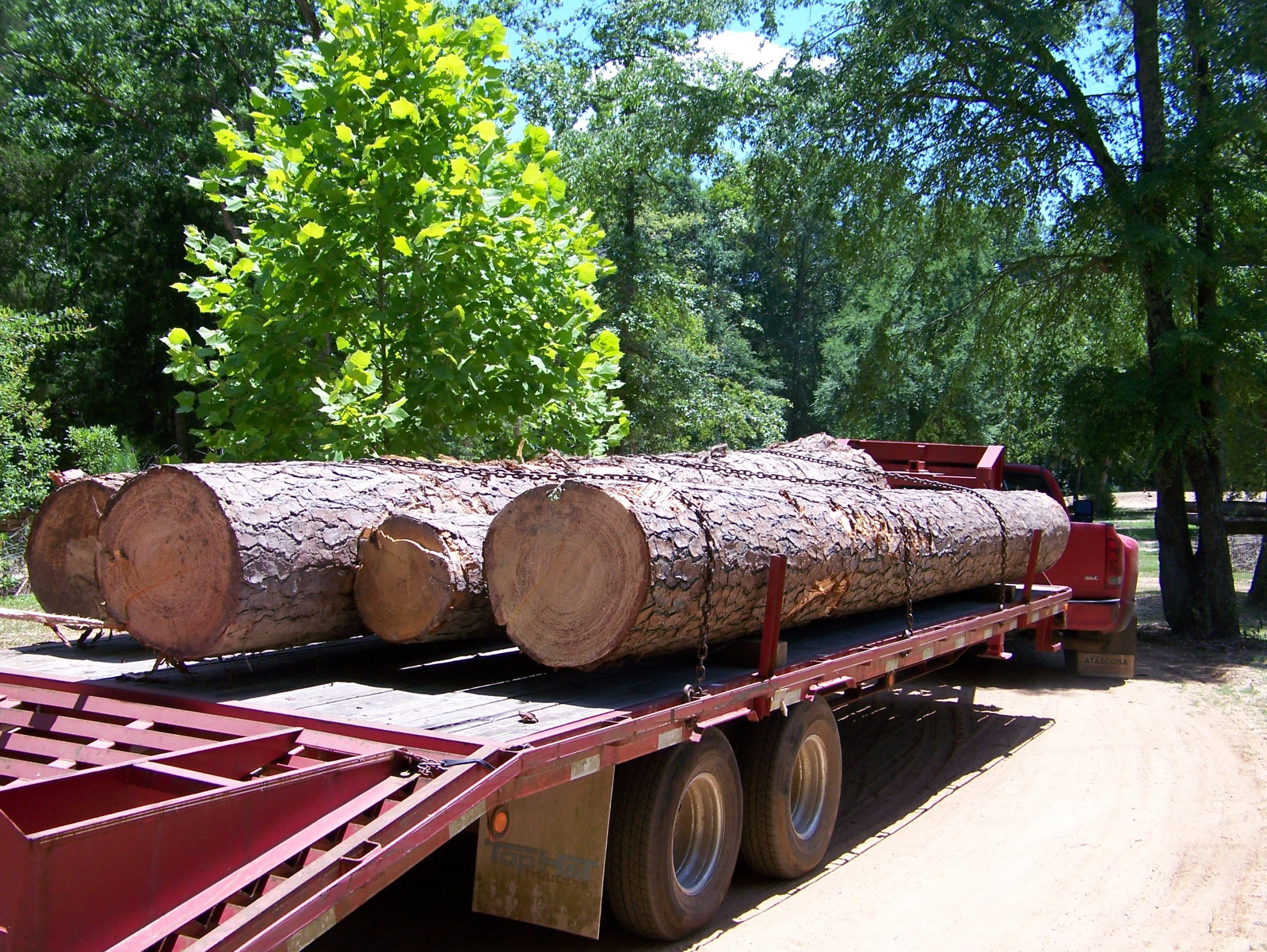

Another free load...............
Biggest one is 37 inches at the butt and 21 feet long.....and over 6,000 pounds.

Larger than what my red pines were. Hope you have equipment to handle the logs in turning to square them. Jon

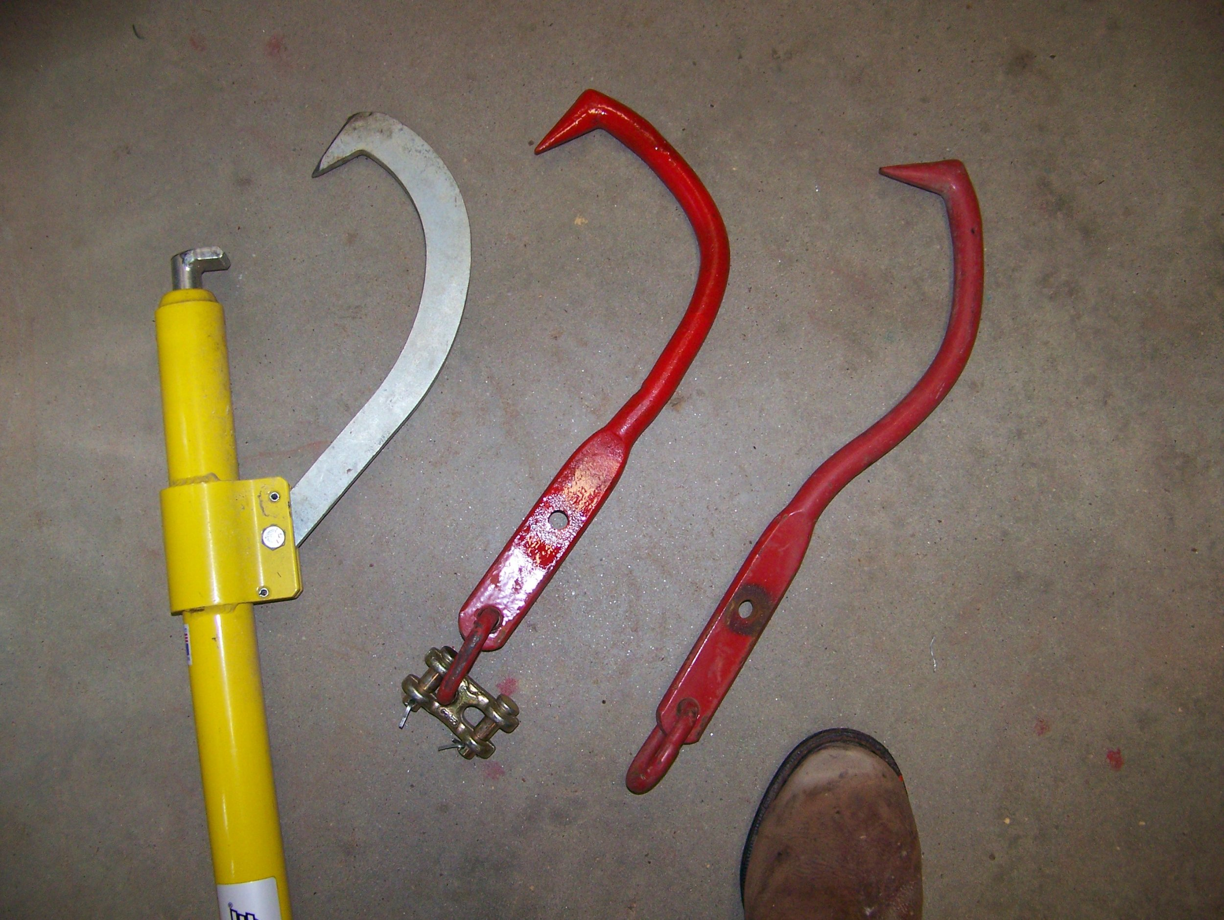

The hydraulics on my WM LT40HD (see post #37) handle it majority of the time. When I have a huge log I need to turn bigger than the log turner can turn, I use this hook in the center of the photo with 12 foot of chain.
Wrap the chain around the log and lift up with the tractor's loader. The chain unwinds and turns the logs as you pull up. It is called a Magic hook, named after Magic Man over on FF.

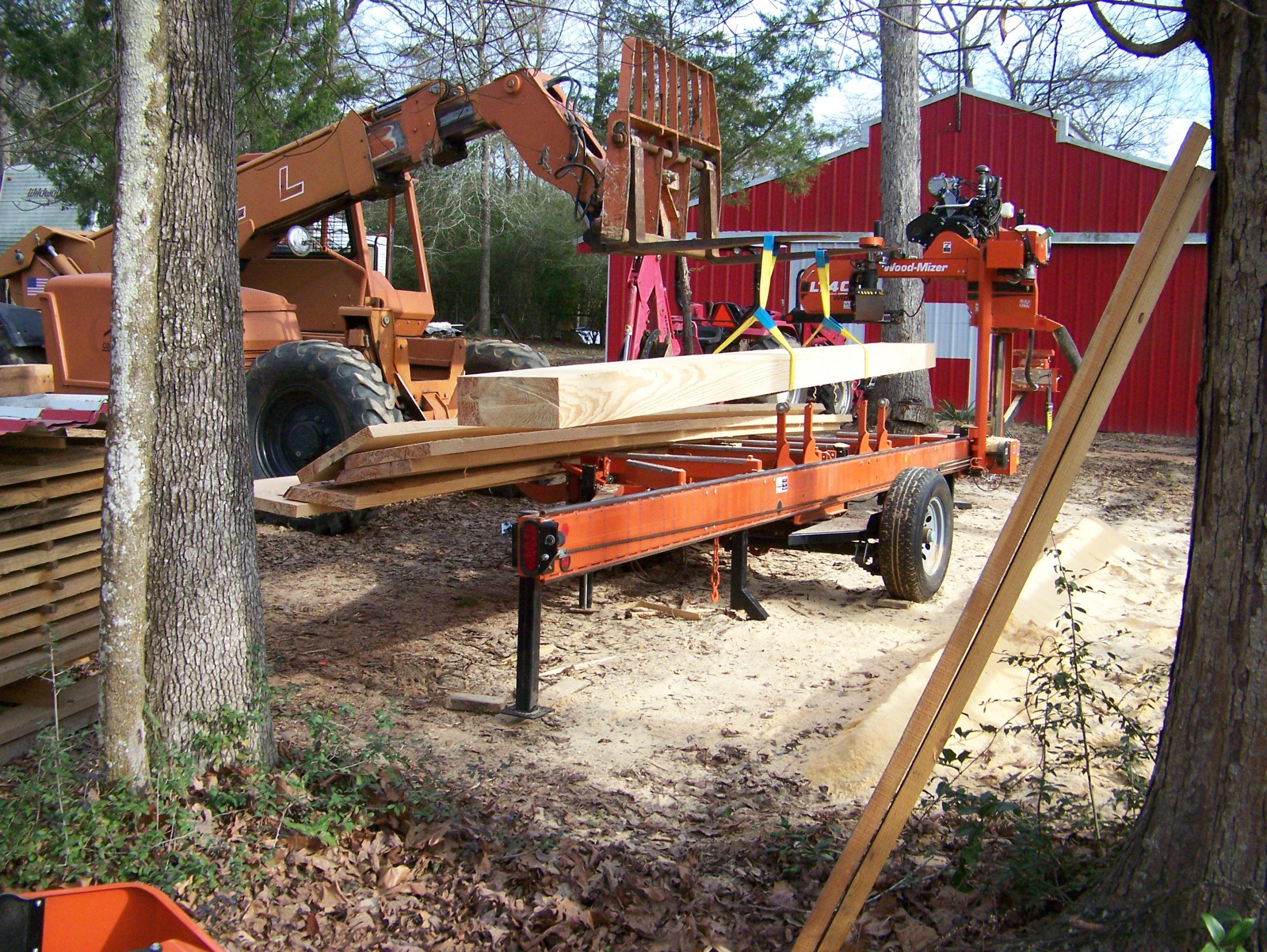

With a huge cant, that you don't wanna tear up with the log turner or chains, I use two 6 foot straps to turn or move.
