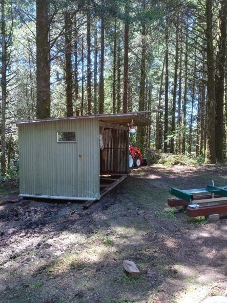

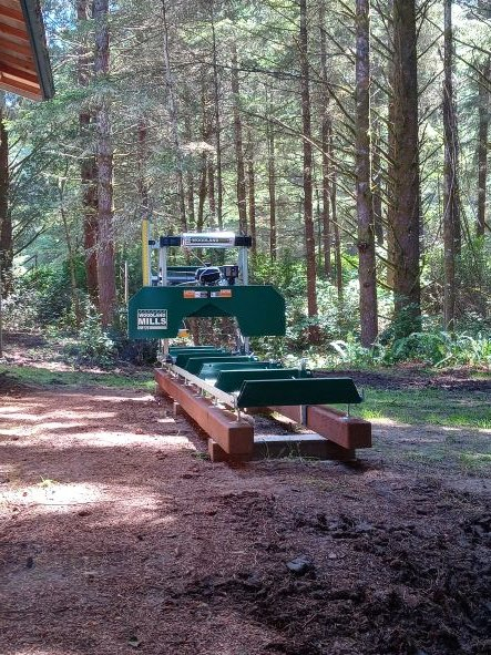

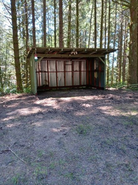

Our annual monsoon finally subsided about a week ago and its just dry enough that I could run the tractor to set the saw head and get the re-purposed shed into place for lumber storage.
