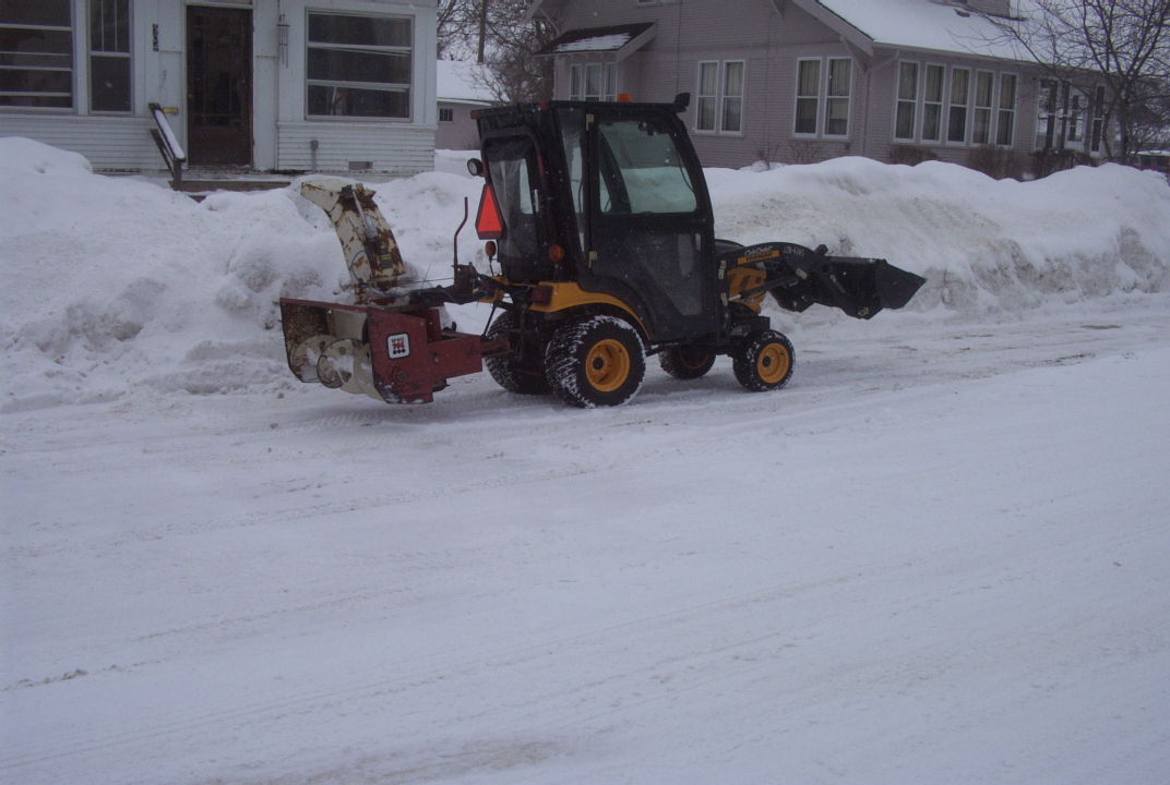

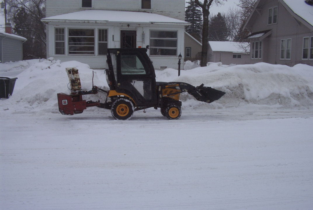

To get by till it happens I took a trip over the weekend and picked up an old Mckee 3 pt model. The down side is looking back but the up side is it is unstoppable. I had to get something as I have a few commercial accts that I promised if they went with me they would not have the cost of hauling the snow away that they had been doing. (it usually costs 3 times as much to haul it as it did to move it around here.) I bought the blower for $800. and another hundred to pick it up.
Can not believe this blower, I have cleaned up the 4' tall bank of snow that was rolled up by the roadgrader since december figured I would have to bucket that out then thought what the heck and turned on the blower backed in and to my amazment it handeled it just fine.
so all is good again in my world (well at least on the tractor front) now just somebody get my leg working again and all will be good LOL.

here are a couple pics of it
talk about your urban snow unit

/ sc2400 SB45 BLower problems #13
Nice. Keep Cub's feet to the fire on the new blower, don't let em run you over. If they can build em that tough on the 3-pt, why not the front mounted ones??
