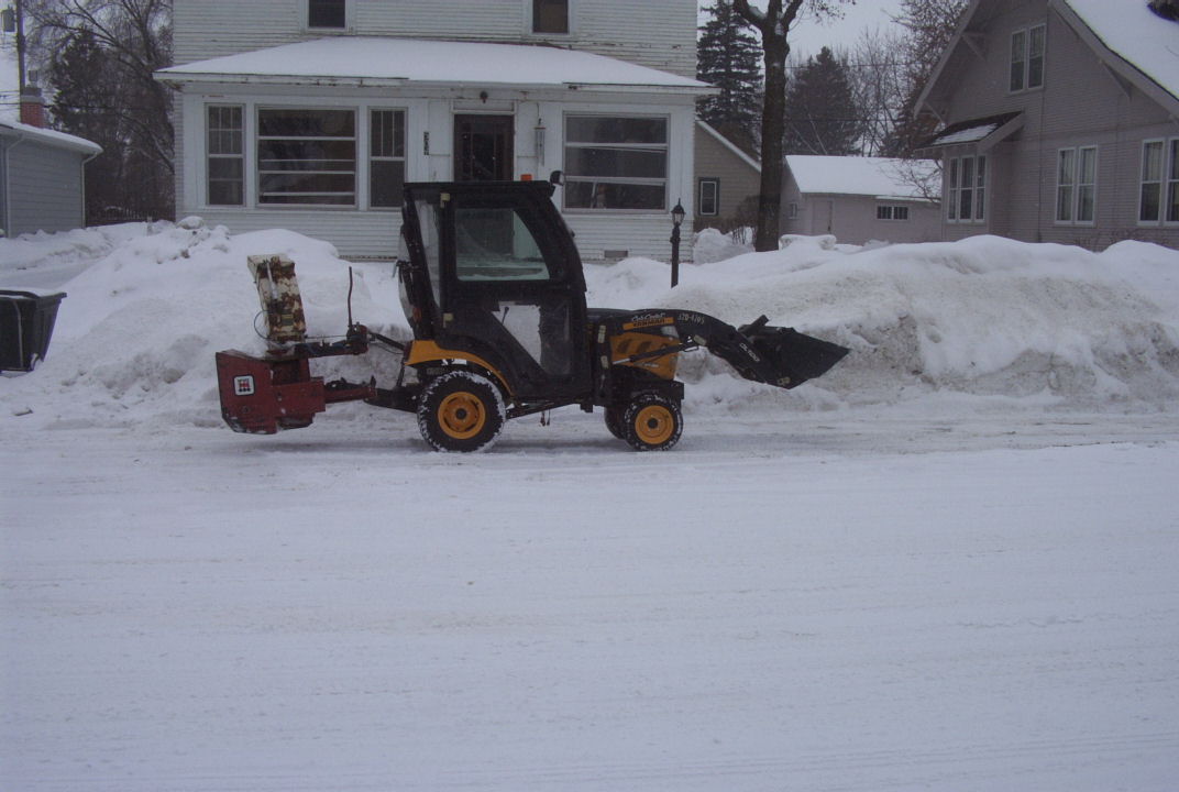

Just picked mine up and put it on last weekend have about 15 hrs on it
a FAntastic piece of equipment
makes the SB-45 look like a kiddy toy
a lot heavier and a lot stronger
/ sc2400 SB45 BLower problems #60
Hi everyone, long time reader first time poster!
I picked up my SB52 the last week in October but I didn稚 have a chance to put it on until this past weekend. I love my sc2400, my loader and my MMM so I knew the SB52 would be great. I ran into a few snags when installing... the first thing was one of the hoses on the hitch came busted off in the cylinder. The second was the small shaft on the hitch (to connect the blower to the mid PTO shaft) was out of tolerance. I tried and tried to fix it but finally I just bought the two pieces back to the dealer. Lucky for me had had both right in the shop and switched them out. Now it痴 installed and ready for snow!!! I love the fact that in about 5 minutes you can have the blower off and the loader on!!
I also opted for the hydraulic rotation kit, it was 420.00 after tax but it is well worth it!!
Something that had me a bit ticked off is that for $4400 you have to buy the drift cutting bars and cute deflector as extras?!?! (4400 includes NY tax and the hydraulic rotation kit) I just cut 26" pieces of 1/4"x 2" flat stock and added them as my drift cutters!!
All in All :thumbsup:
