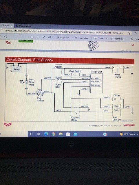

We actually just got it back today. I didn't get to speak with the tech, my grandfather did. Unfortunately his memory is a little slow at the ripe old age of 86. He said the tech said it was a solenoid up front. I'm assuming it was the starter solenoid. Is there any other one on it? Would it even turn over if the starter solenoid was dead? I'm going to give them a call on Monday. The teck has gone home for the day . . .
   / sc2400 won't start. . . #14
if it was the starter it wouldnt turn over. Right? and if it was a fuel pump why would the sediment bowl fill back up?
   / sc2400 won't start. . . #15
do they have a solonoid on the fuel line that shuts off flow to the injectors?
that could be a possibility
#16
That sounds more like my problem. I bet that was the one that went. I'll confirm on Monday. Thanks guys for all of your thoughts!!
