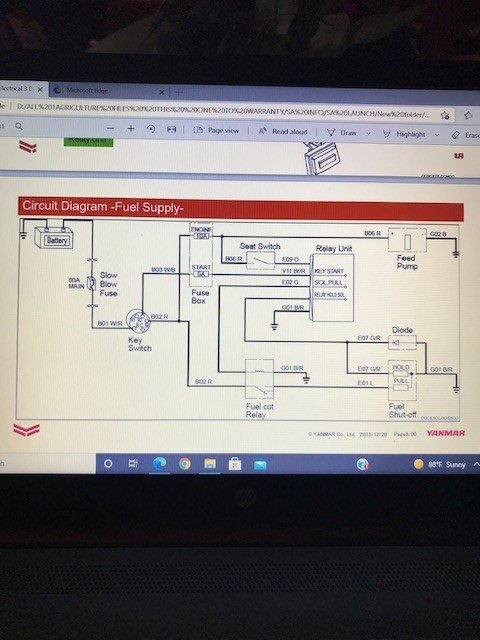

im having a similar issue. Just cranking with no clicking. Replaced the electronic fuel pump...still no clicking. Whrn I turn the key either to preheat or start my flashers on the dashboard light up very faintly....do know why...its never done that before. Where is the solenoid????

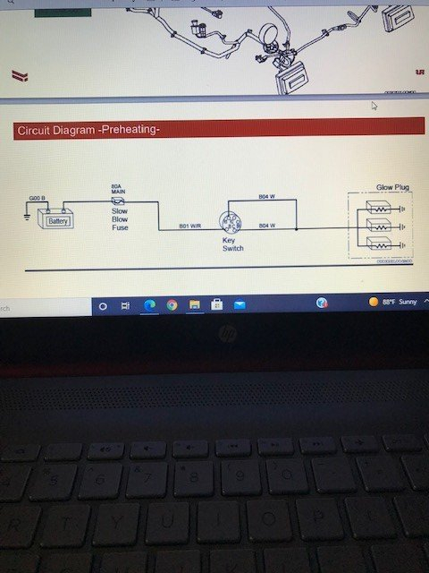

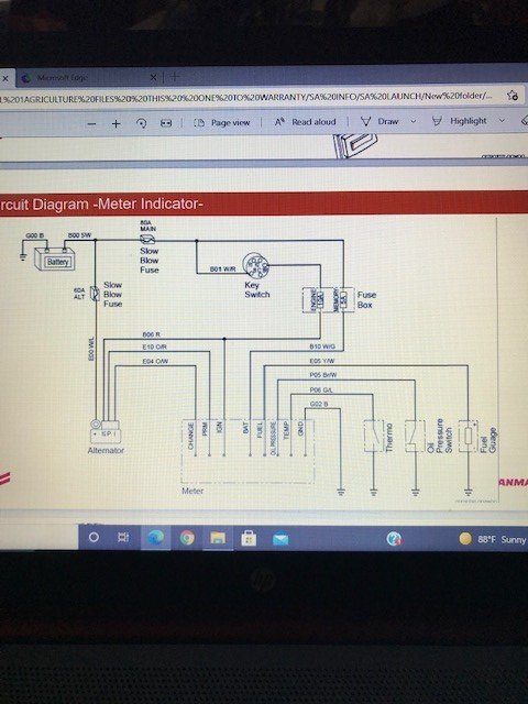

Please see attachments for the SA, thought it might help with some issues, contact me as I might have additional machine info on the SA
