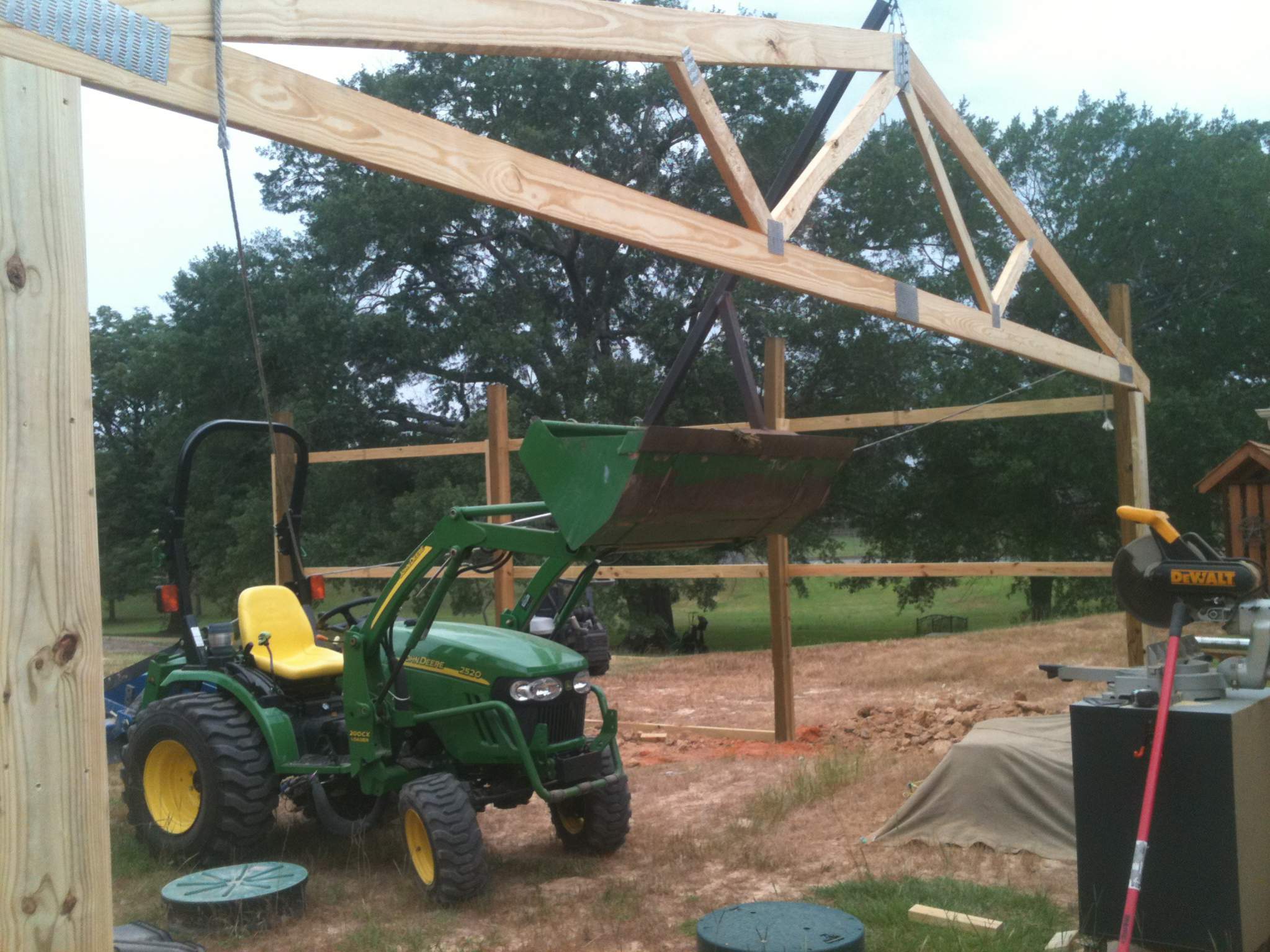

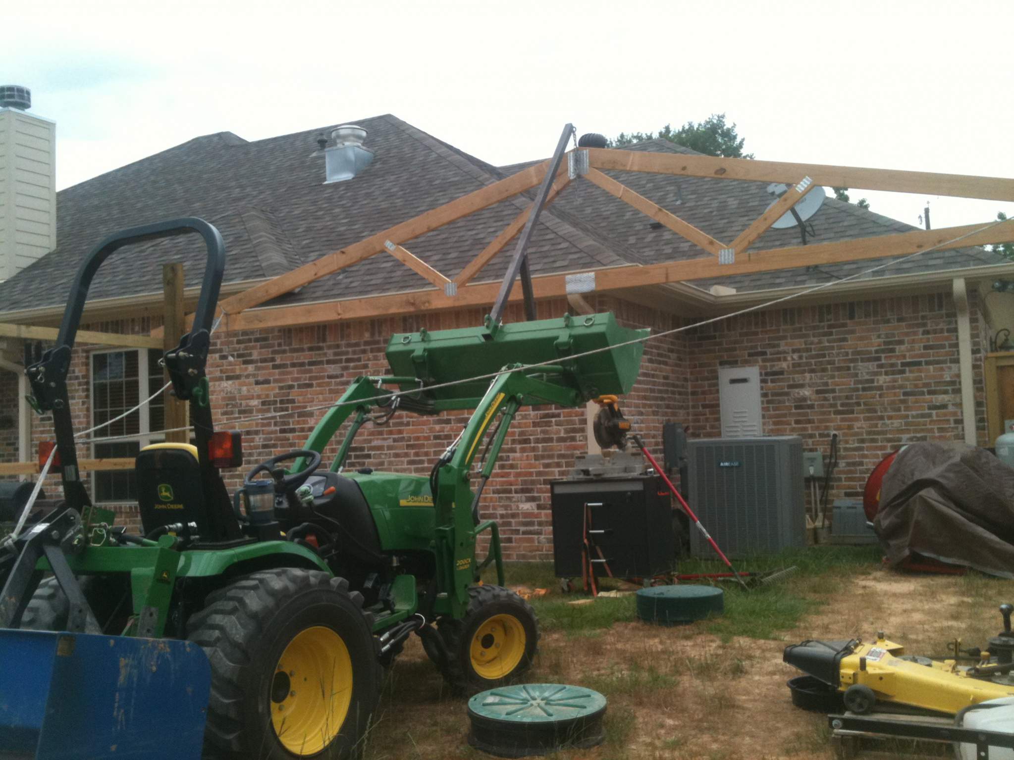

I just set trusses with a boom pole that I made to fit the receiver on my bucket. I also triangulated down to the bottom of the bucket. If you'll notice in the pic, I tied ropes to each end . I set them by myself and it actually took longer to tie on than to set them

Does that boom support attach rigidly to the front edge of your bucket, or is it just notched to grab the bucket edge?
Connecting the roof on your addition to your existing house is going to take quite a bit of skill, or maybe I don't understand how it intersects with the house.
Beez, the triangulated support comes down and rests on a 2x2 angle iron setting on the edge of the bucket....hopefully you can see it in this pic.

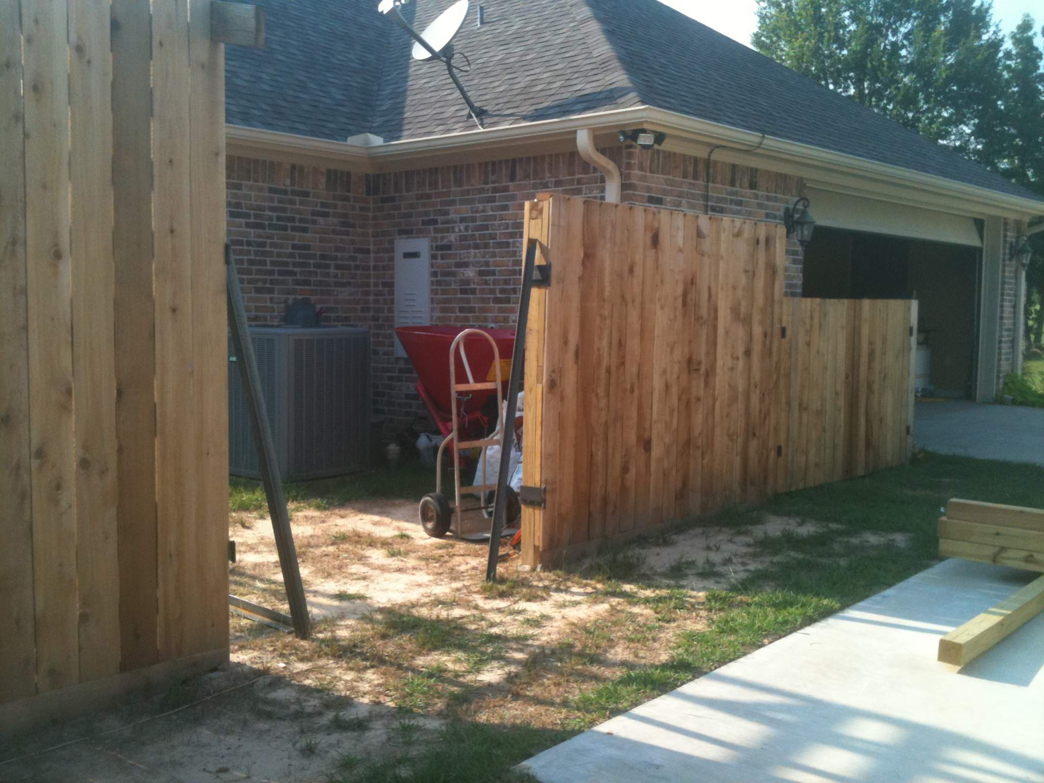

The "garden/tool shed will be separated from the house by privacy fencing to match the walls of the shed...here is a pic in progress without the gate mounted yet..again not a good pic. The short 4.5 ft far end is for our trash cans ,then it steps up to 6 ft privacy fence and then finally the 8' garden /tool shed. I'll try to take better ones tomorrow

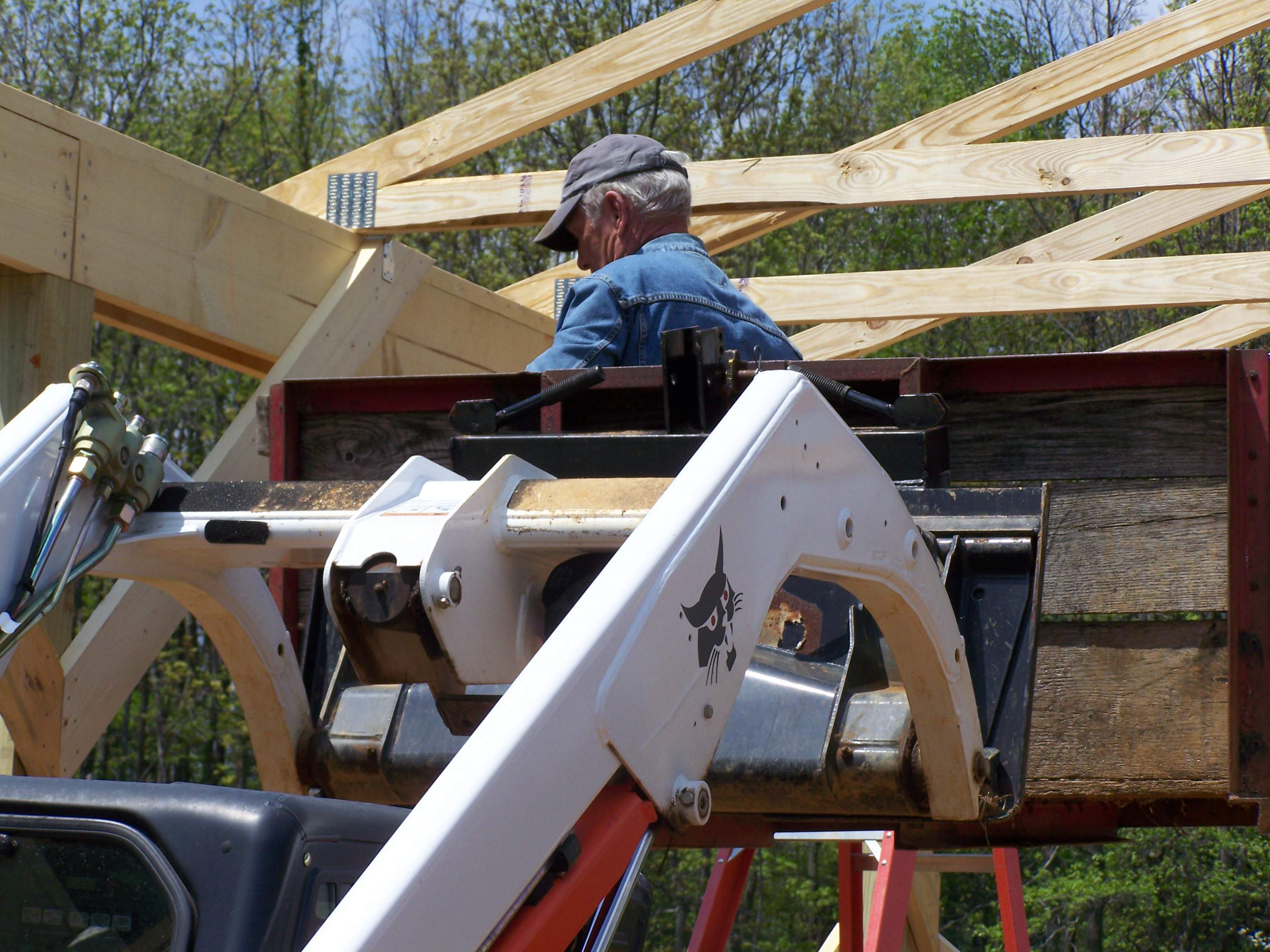

A scaffold on the FEL looks really useful, I could have done with one a few times. But how safe is this? My tractor manuals and lots of reading tells me that one should never carry people or ride in the FEL, this referers to when the tractor is moving, but I'd assume that the same would apply.
If the tractor is off then any movement of the joystick will cause the pressure to be released and the FEL to crash down so I presume the tractor has to be idling? Even then does the FEL/scaffold stay up in the air? does it slowly lower as pressure leaks out?
Mike
You are correct. The loader is intended for material and not people. Not OSHA approved.
That being said, what I did was build a three point adapter, for my loader. I connect my carryall to it for a work platform. I have also used it with a 3 point boom pole setting trusses. With the OPs design, you pick up a little height, it being attached to the top of the bucket, which doesn't hurt.
Yeah, all this stuff is use at your own risk.
I see it, thanks.
I see, that will be nice.
