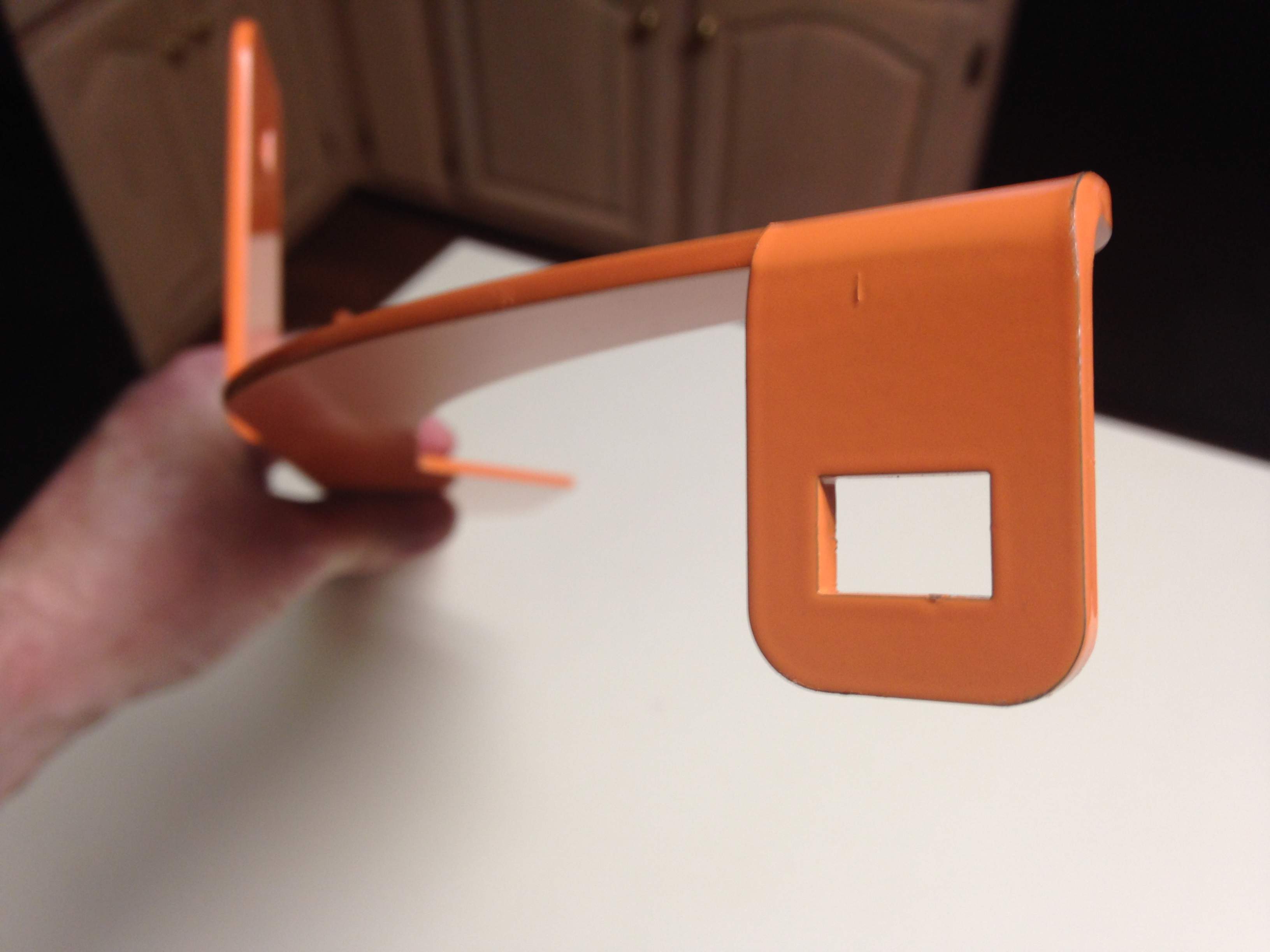

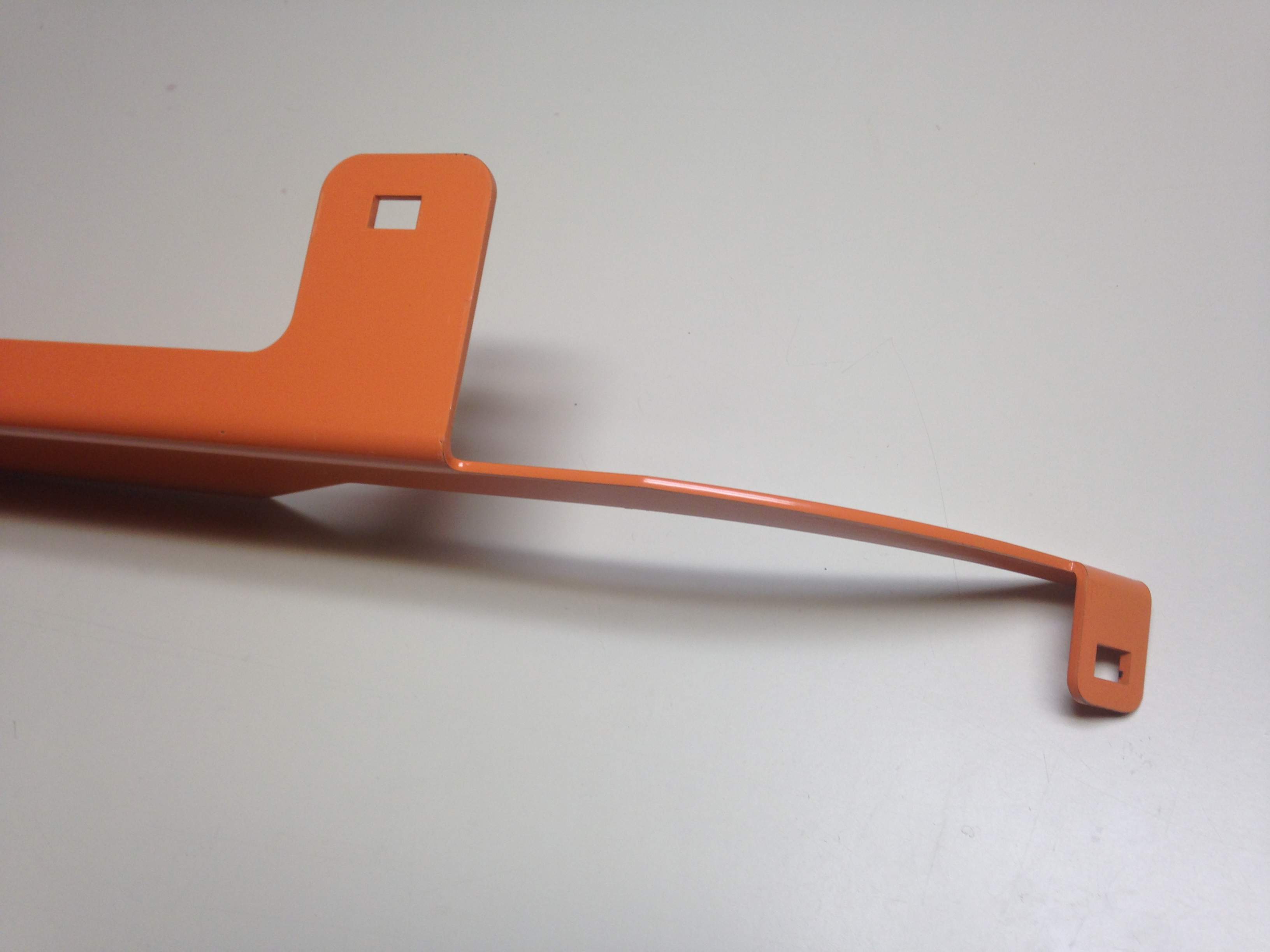

It works great, very happy I found this and thought I would share a few pictures, every freedom Z owner should have this!
PN# SG 424743
Description: Scag LH BAFFLE, GC-48
"This is for a 48" deck"

Not to dig up an old thread, but I ordered a baffle for my Freedom Z 48". Bubba running the stamp machine must of been thinking about Miller time. Notice the small end tab on mine. Bent 180 degrees out.
/ Scag Freedom Z Issues: #16
Haha!! I think you're right!!
"Inspected by Bubba"
