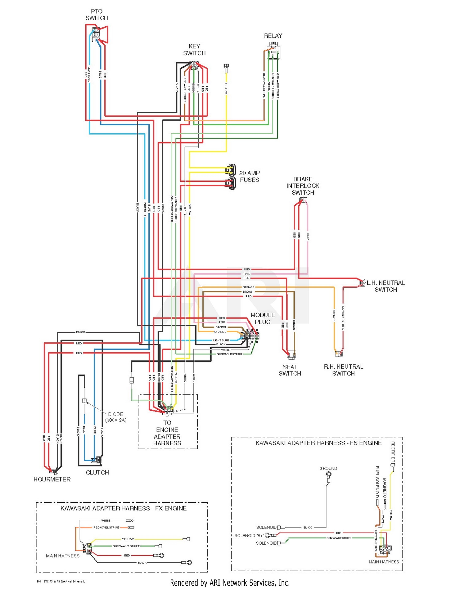

Scag 48" Tiger Cat II W/kawasaki 22hp engine
Question! I have a Scag 48" Tiger Cat II with the 22hp Kawasaki engine. Key does nothing so I tried jumping straight to starter. Started right up so next I thought solenoid. I noticed in the wiring diagram that there is a diode in the wire going from the ignition to the solenoid so I ran a wire from the ignition to the + side of the solinoid. Starts just fine! Sure enough there is no continuity from the key to the solenoid so I suspect the diode is bad. I was an electronic specialist in another life so I know that a diode let's current flow one way but not in the other. My question is this, what is the risk of bypassing the diode and just running a wire from the ignition switch to the solenoid and if it will cause damage anyone know the location of this diode? Any feedback is greatly appreciated!

are you sure the diode isn't across the coil terminals of the solenoid?

There are a lot of components between the key switch and solenoid. Namely the pto switch, seat switch, parking brake switch, the brain box that controls everything to name a few.

green wire and green with black stripe? Is the diode across the relay coils. It would be best to replace the diode, its job is to help keep the relay from burning out when it switches legs.

If I am looking at the same schematic as you......looks like your mower has a "module" or little brain-box thing.
Looks like that diode protects that brainbox from the voltage spike when the starter solenoid field collapses.
If thats the case....I'd either test and/or replace just that diode. Most cheap volt-meters will test diodes.
But RandyT's statement of alot of components between the key and starter.....yes and no.
Its NOT like a continuous series circuit daisy-chaining through all the safetys and if any single one is open it wont start.
All the safety switches go through that little brain-box. And if the brain-box gives the "all-clear" to start, it gives the ground for the start relay on the green and black wire. The relay then gives the start solenoid 12v on the green and white wire.
Thats my amateur diagnosis.
And as cheap as manufactures are anymore....I would find it unlikely for them to put something there (diode) that wasnt actually needed.

Classic "flyback diode", essentially a surge suppressor, as LD1 suggests. If bad, just replace with similar type and size. DigiKey is your friend, they do small credit card orders for personal stuff. Heck, you can probably get them on Amazon now, too.
Where's the schematic you guys are looking at?

[wiring diagram]
Thanks. Unfortunately, it's hard for someone not already familiar with these mowers to get much from that wiring diagram, if you don't already know the components at each end. I have no idea what's on the other end of "module plug", and that would be required to figure out the pin-out of "relay", and thus what that diode at the engine adapter harness plug is actually doing.
The reversed 600V/2A diode at the clutch is a classic example of a flyback diode, reversed biased and there just to absorb a transient when the clutch is disengaged. But I assume the one in question is the one at the engine adapter harness, and its function is less obvious from the wiring diagram alone. I'd guess LD1 is right though, it's for protection of the engine module electronics.
/ Scag start problem #14
The other side of the "module" plug is just that....and electronic module.
However, it has nothing to do with the engine, and isnt an "engine" module at all. Rather it is a safety interlock module. All the safety circuits go through it (instead of daisy-chain fashion). And if all safety's are in their proper position, it will give the ground signal to the start-relay.
IT also has some kind of "logic" to it. Meaning if blades are ON and seat becomes unoccupied, it kills the mower and deck. OR if park brake is set, but handles come off home position.....also kills the engine. Or as long as park brake is set, handles in "home" and PTO is off.....it ignores the seat switch (meaning you can get off without killing engine.
Again, its got a "logic" base to it. And being that its a printed circuit board....my best guess is the diode is preventing a voltage spike on that board when the starter solenoid is de-energized
