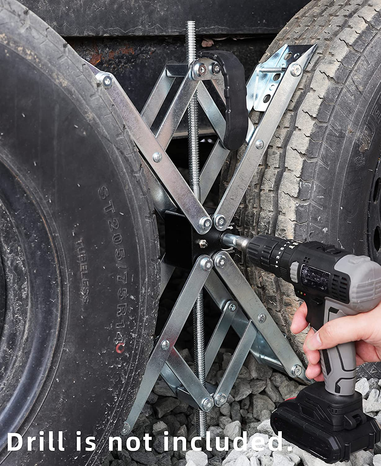

Always good to learn something new. We trailer horses and often when unloading at a show grounds are on not level surfaces. Trailer wheels will always be chocked when loading or unloading now...... and truck in 4WD. The horse does not weigh as much as that tractor I am sure, but no taking chances.

That’s actually pretty common. Even with supports on the ramps it can still happen because a lot of times they’re too short to reach the ground. The safest thing is to park the truck at the bottom of the hill. If that’s absolutely not a viable solution the trailer wheels need to be scotched and put the truck in 4x4 if equipped. Having a second person hold the brakes would be preferable.

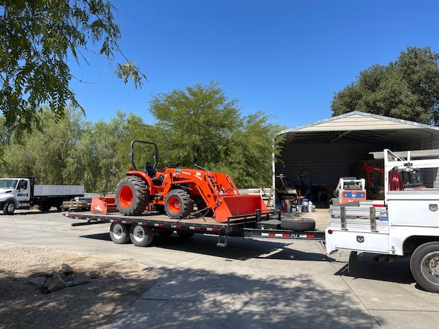

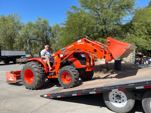

Another solution may be the tilt trailer if you are shopping around. The guy I bought my tractor from had a nice setup.
