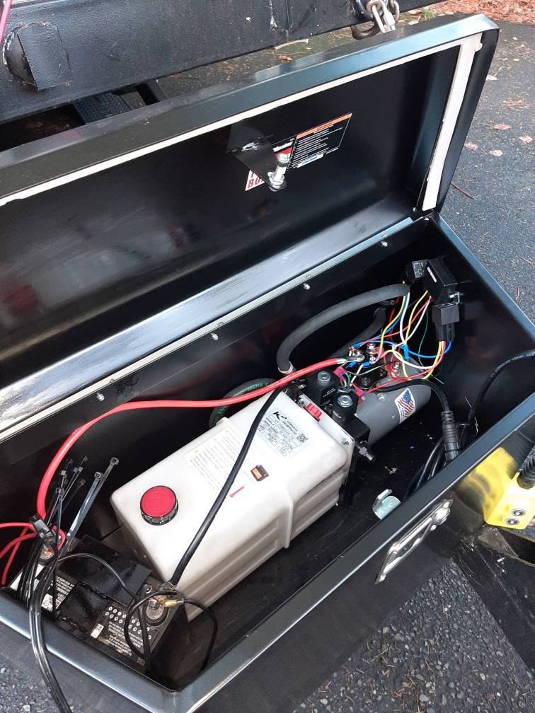

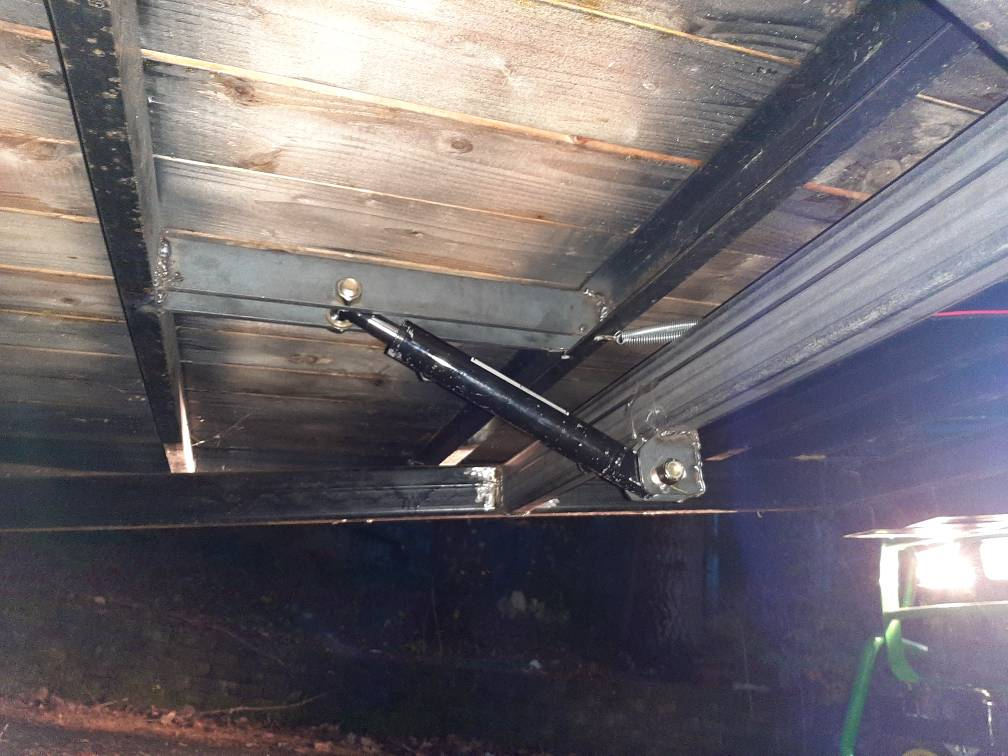

Ouch! I am glad I have a tilt deck. I added hydraulic lift to it so I can actually push down on the back of the tow rig. Although the Reason I added the hydraulic setup is I can drive pallets up on the deck one at a time with my tractor without the front dropping.
