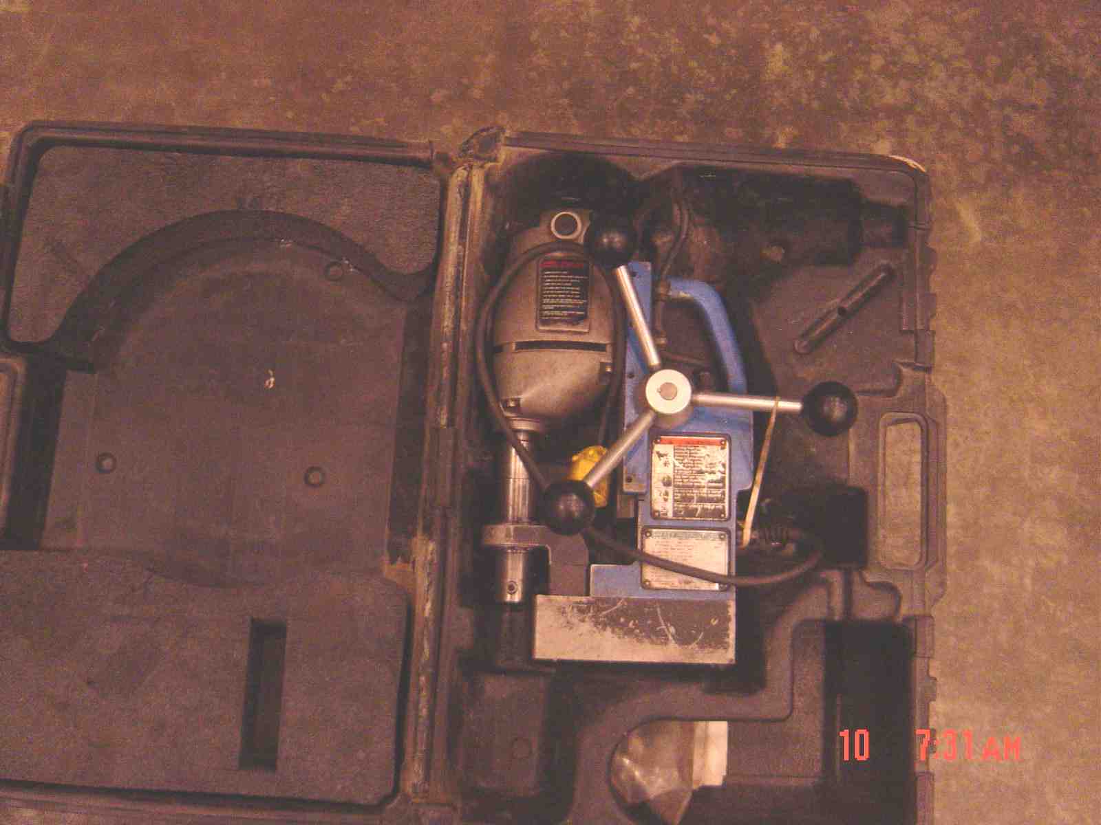

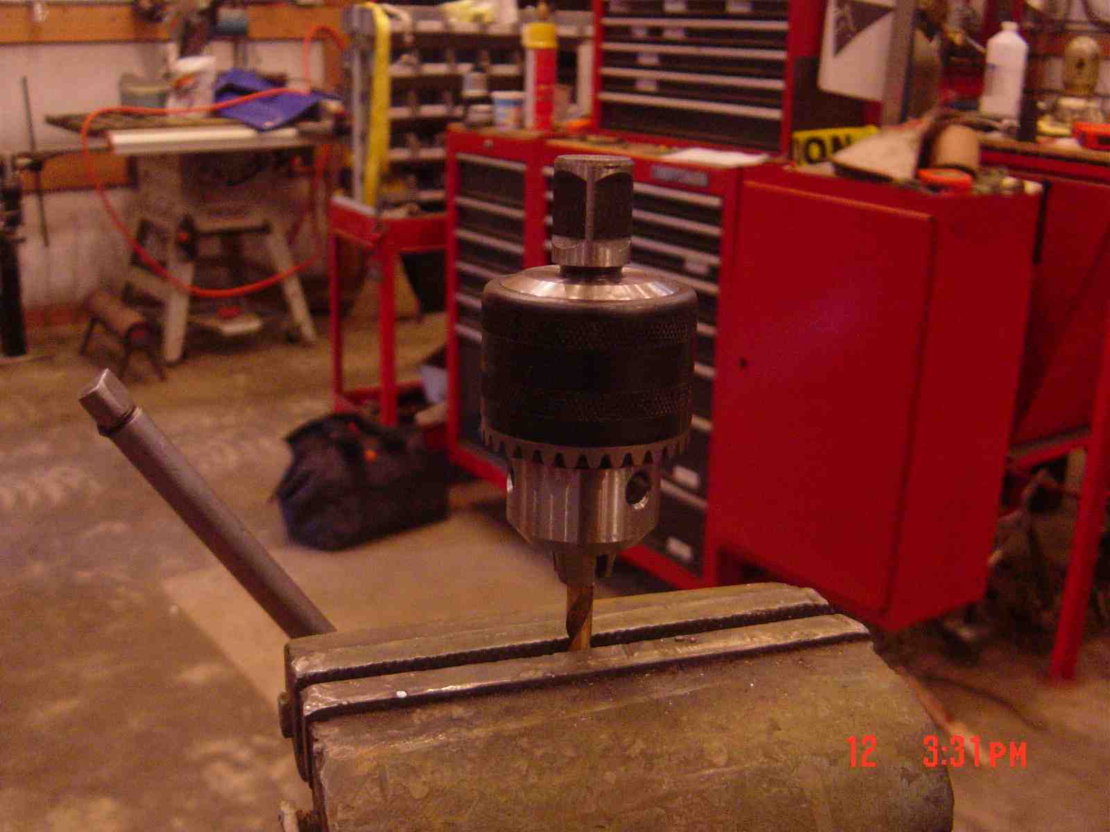

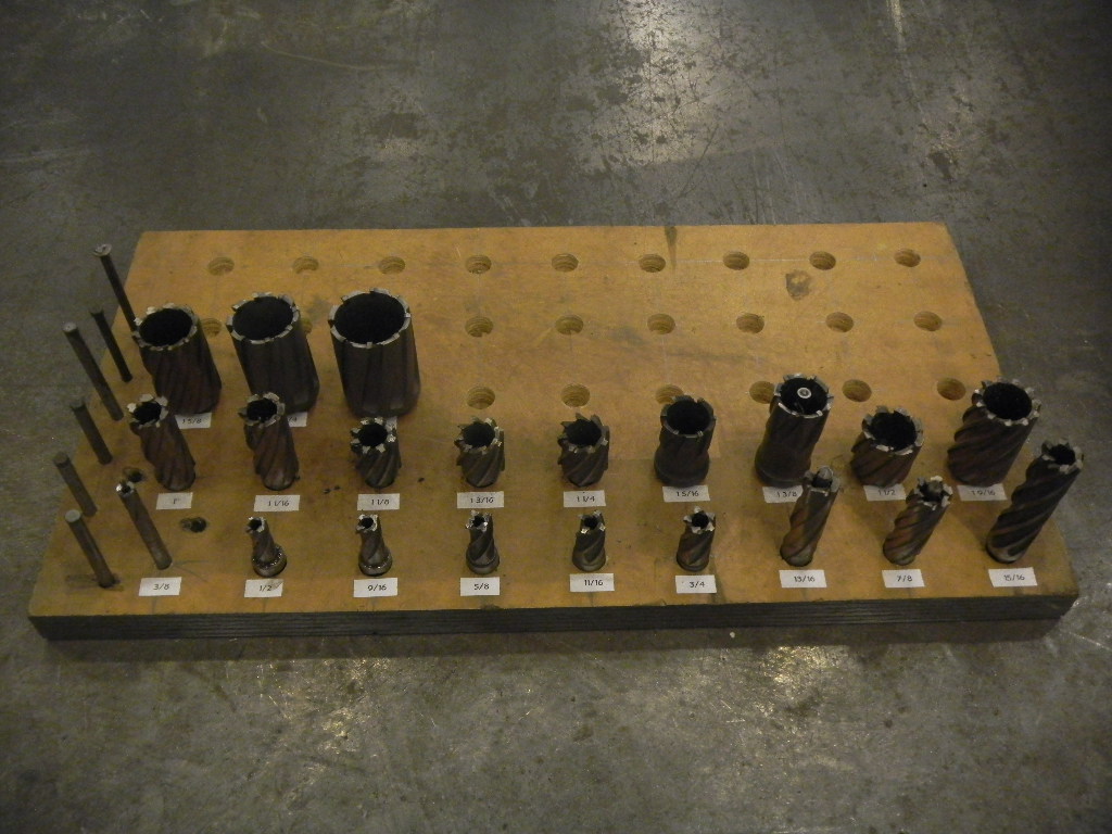

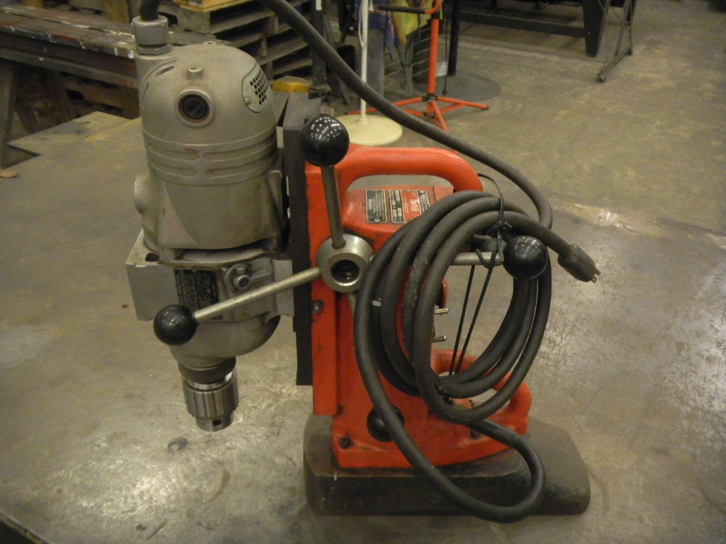

I have a Milwaukee mag drill, and a Hougen, with a drill bit adapter.

   / School me on magnetic drills #5
GOOD GRIEF!!!
Is there no end to your equipment inventory. :eek: :laughing:
