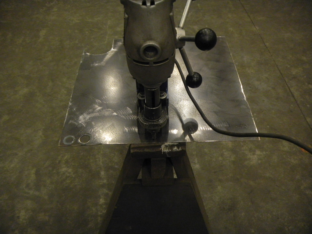

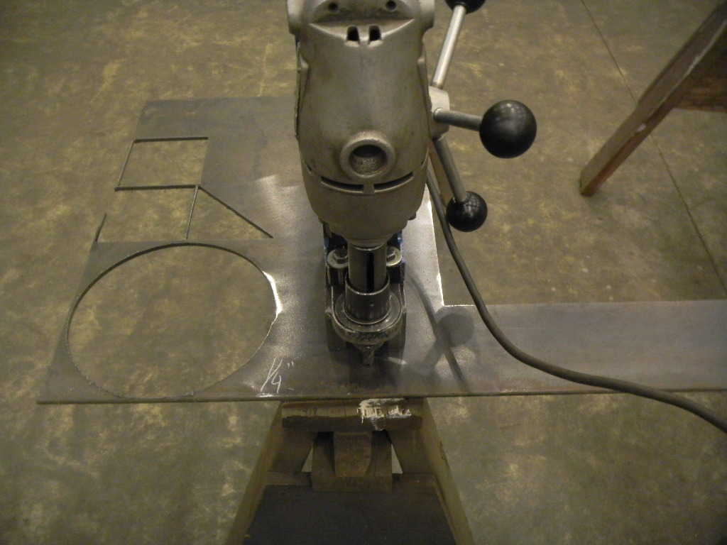

I have heard before that Mag drills won't hold onto thin metal, but I never tried it myself. So today I did! Some 16-GA, 10-GA, and some 1/4-inch plate.
The 16-GA the Hougen wouldn't even attempt to hold on. The 10-GA, maybe if you were really, really careful you might get away with it. The 1/4-inch plate I couldn't get the magnet to break lose at all.

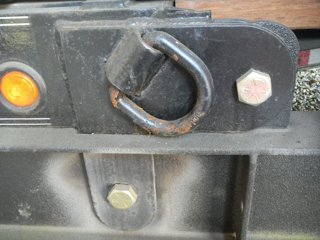

Mag drills really do come in handy at times. When I built my gooseneck adapter, instead of drilling the holes first, then trying to get everything aligned up before welding. I just installed everything, welded it off, and drilled the holes in place with the Hougen.:cool:

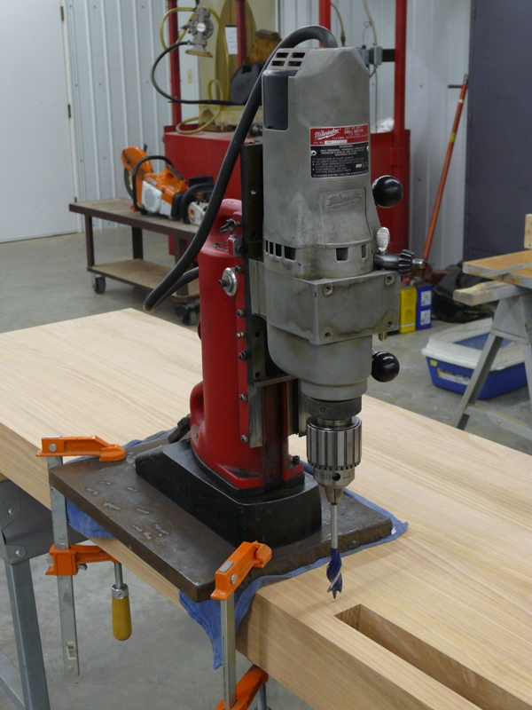

For years my only drill press was a Milwaukee magnetic. I kept a piece of 1" plate on my wood topped bench for it, when I built my current bench, made the top from 3/4" plate so the mag drill could get a good bite.
They are a very useful tool to have, longer stroke than a drill press ever thought of having. What you can do with one is only limited by your imagination. Mine worked out great for drilling the dog holes in my woodworking workbench.
