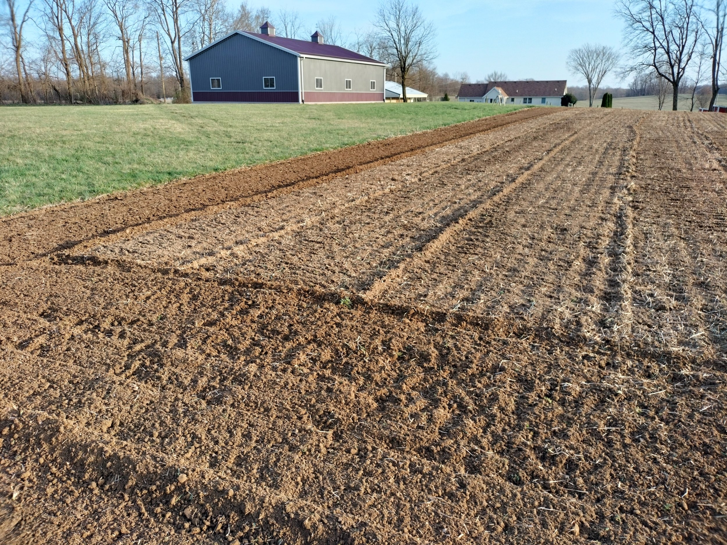

You don't need to remove the shoes. You had it right in your post above when you observed that the shoes were riding on the unbroken ground.
Your tiller was riding on the shoes on the untilled ground on both sides ON THE FIRST PASS.
Now move over about 4' and make another pass. The shoe on the already tilled side will drop into the soft tilled soil and you'll go much deeper. On the untilled side, it will still ride high.
After you've broken the crust across the entire area you plan to till, the tiller tines will drop as low as your three-point hitch will allow it to drop. No need to remove shoes. They'll drop into the fine tilled soil as long as the ground is adequately dry and conditions are right.
I've never adjusted the shoes on my tiller. They ride on the crust on the first pass. After that, they just drop into the tilled soil.
After I've made a couple passes with my KK tiller, I can push my hand into the soil past my wrist. It just turns it to a perfect seedbed as long as you do it when it's dry enough. Your feet will sink into it several inches when you walk across it. No need to remove or adjust the shoes.

What you tilled up looks good. As soon as you break the top crust all the way across, your tractor tires will be sinking into that fluffy stuff 4 or 5 inches and your tiller tines will drop as far as the hitch will allow.
Enjoy. Nothing like watching a good tiller turn rough weedy areas into a seedbed.

I agree with what many have stated, I would be thrilled if my first passes looked like that. Leave the shoes on and overlap any way that works for ya. Besides those shoes might help prevent some rock damage if you have any hidden rocks.

Make a couple passes, and the shoes will continue to sink in the soft soil… you’ll get 8” deep likely. For this reason I don’t set my shoes very deep. I like to make a couple passes anyway.

Well that was 3 passes I think, but yeah it looks pretty good! I am sure it will pack down a little bit.
I’ve never been able to get more than 6-7” of depth with a tiller, even with the skid shoes off. Think about the purpose. For deep root development that’s where a plow or subsoiler is used to open the ground deep. The tiller is just to fluff up the upper seedbed to allow seed germination and small plant development. Once a plant grows and starts to sink down deeper roots, it’s large enough to move into the deeper soil that was broken by the plow. I always plow first, then till. Then plow again in the fall to allow deep moisture penetration and frost heaving to churn the soil.
We did use a ripper down about 9 inches before we tilled so I am sure that will help!
Thanks for all the replies. I feel better about our performance now.
