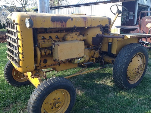

The same guy that I got my Ford 755 backhoe from gave me a Schramm 300 pneumatic tractor
it has a 4/71 Detroit engine with a 300 CFM compressor coupled to the engine. the tractor is propelled by a pump mounted on the front end of the Detroit.

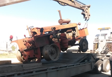

I remember about 30 years ago it had a backhoe boom mounted on it with a large pneumatic hammer. Later on he sold the boom off of it and mounted the hammer on his excavator then just used the Schramm as an air compressor About 20 years ago he converted to using a 2000 lb hydraulic hammer and the old Schramm has been sitting ever since. Now that I finally have it moved to my place the other day I thought what the heck I might as well find out if it is locked up or not.
after checking all of the fluids I hooked a battery to it just to see if it would even turn over. It did but not enough battery to start it. I really didn't want to start it with out first making sure the fuel rack is functioning and the shut off. plus I want to drain the old diesel out and change the filter before I actually try to get it running anyway.

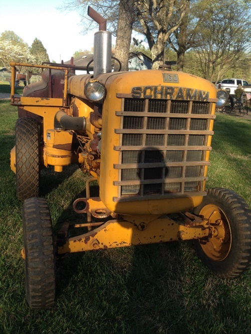

It's a 1969 model

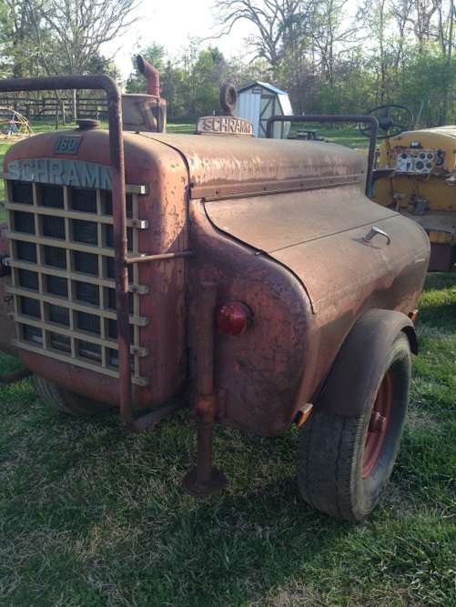

That's a neat piece! We have 2 Schramms, one pnuematractor and one tow behind. They are both gas engines and both 160CFM. Both run/work. Our tractor belonged to the U.S. Navy and still has the brass tag attached and also U.S.N. stamped in the tires.

I wanted it for the huge air compressor not having the hoe ram or boom any more is a little bit of a negative because that makes the old tractor incomplete from the aspect of originality, and they never were intended as any form of Agg use but if it does what I really want it to do which is to use as a means of blowing out my 60 ft deep water well that has silted in so bad it can only produce a couple gallons per minute, I'll be happy.
Depending on the out come of cleaning out the perforations plus loosening up the sand and gravel of the strata I might later build a telescoping and folding boom style derrick to assist in pulling wells up to 2 or 300 feet deep. The local well driller guy said that he would welcome having a machine he could rent for those times when he can't get his big rig in without a lot of work
Who knows there are a lot of possibilities for the old machine I can always use it to run my sand blaster and not have to rent a compressor.

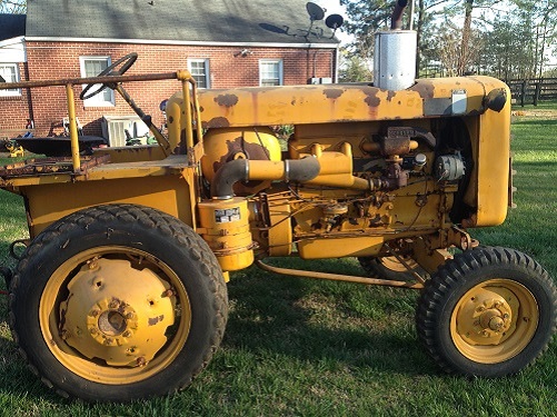

Been thinking for a while now that I needed to do something with the Schramm.
I blocked it up on blocks removed the wheels and started looking for used tires to put on them.
Not having any luck finding the size I wanted without having to buy new I decided why not make some adapters and just put truck tires on the back all it really needs to do is to have something to roll on anyway.
Plus I had 8 385/70-22.5 mounted tires from a trash truck. these things are huge and heavy plus 2 inches wider that the agg tire that is supposed to be on it and only 3 or 4 inches smaller OD
So if 2 tires were good enough to roll around on why not just put 4 on for more surface area
