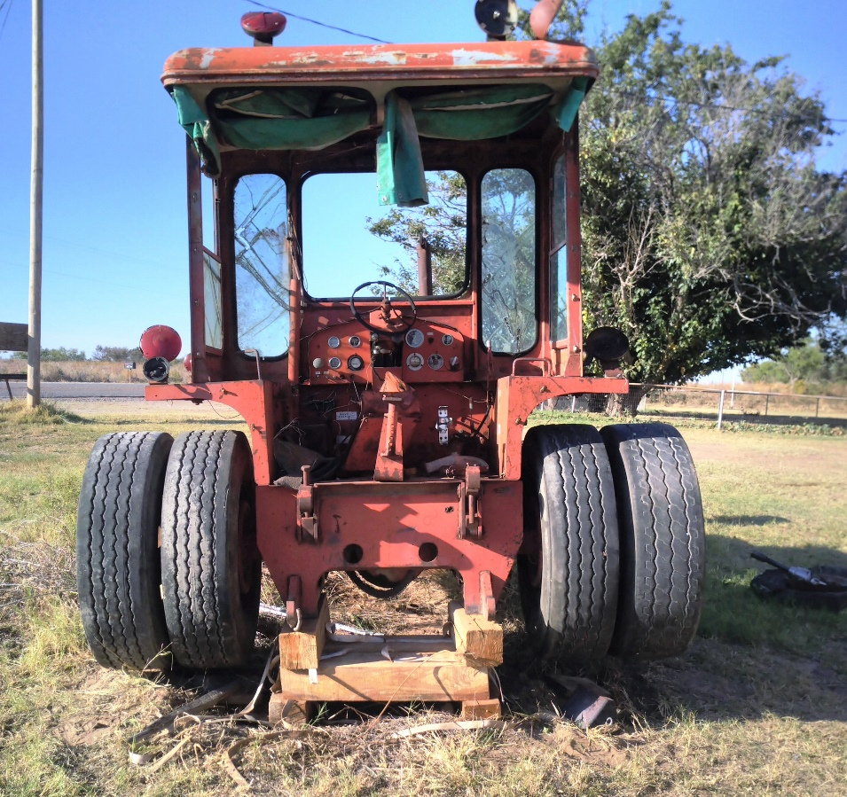

Been thinking for a while now that I needed to do something with the Schramm.
I blocked it up on blocks removed the wheels and started looking for used tires to put on them.

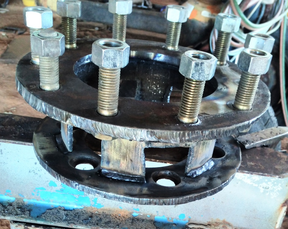

Not having any luck finding the size I wanted without having to buy new I decided why not make some adapters and just put truck tires on the back all it really needs to do is to have something to roll on anyway.
Plus I had 8 385/70-22.5 mounted tires from a trash truck. these things are huge and heavy plus 2 inches wider that the agg tire that is supposed to be on it and only 3 or 4 inches smaller OD
So if 2 tires were good enough to roll around on why not just put 4 on for more surface area
