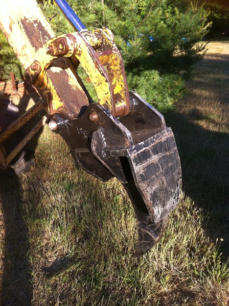

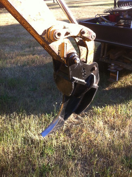

MT, used the 'hook' today, I did, digging up stray autumn olive and some elm saplings by the roots. (it never ends)
btw, I had to go a bit beyond MIE's std 'worksheet' when ordering due to T5's non-typical bucket hookup config. (second pic) Bob & Tony are more 'custom capable' detail-wise than is apparent from their website. This tool is seriously rugged & I doubt I could ever bend or break it ... or the Hound Dog grapple they built for me. ;) Michigan Iron and Equipment, Kioti Tractors, Kioti Implements, Kodiak Attachments, Befco, Hound Dog Attachments, Dk Series Tractors, Central Michigan
