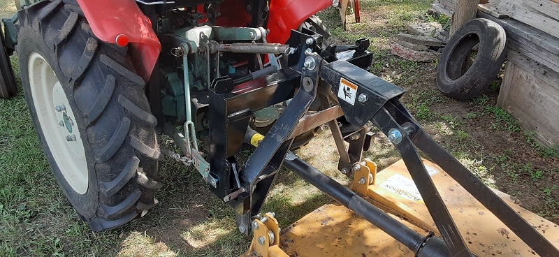

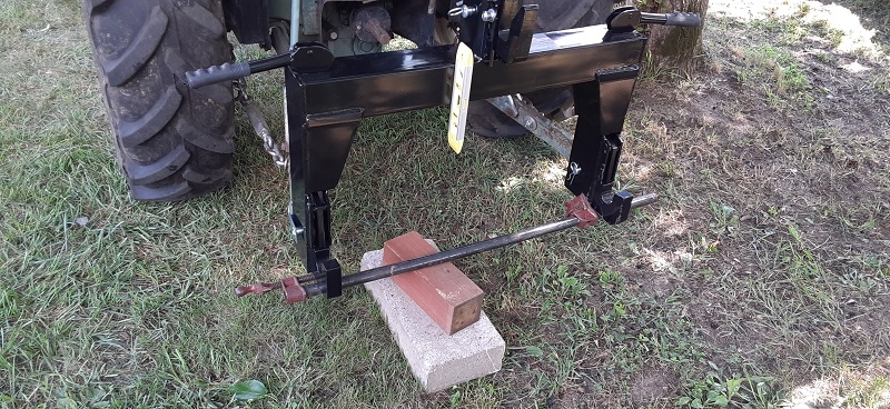

Yes.And, if I remember, they emphasize the clearance because the first ones were too narrow.
Bruce
When they first came out, many on here were widening theirs with a Farm Jack to get it to the SAE(??) standard to fit modern implements. Mine needed about 1/8" before it fit my Howse rotary mower.
As is often the case with HF's stuff - Some Assembly Required.
