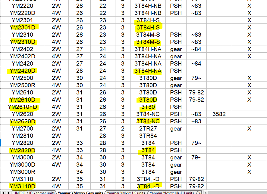

One day, when I've got a shop to comfortably do the work, I'm going to buy an old Yanmar.
Between @bmaverick and @California you guys have really made the case for them.
To match your CK2610 for diesel power, 4WD, live PTO, PowerShift, and with popular engine for parts, these are exceptional models,
If there is an X in the far right column, the YTOG has a Parts Manual for it. :)

In the Yanmar YM models, this is how things go for the most part, there are EXCEPTIONS.
YMxx00 = no thrills, geared machine, with rpm and tach with hour meter.
YMxx10 = above basic model, PowerShift, rpm, tach with hour meter, more multi-PTO speeds, and additional options
YMxx20 = plush of options, all the bells and whistles, PowerShift, more gauges and lights on the dash. Some even have power steering equipped.
Toss a D at the end of the model and it's 4WD.
PowerShift models provide 'live' PTO in the selected operating range.
Options range from
- Power Steering
- Draft Control
- Multi-speed PTO in the tach meter
- Wet brakes
- SCV (pre-Power Beyond)
- Power Beyond
- Swivel seat
- Cabs
- Front PTO
- Mid PTO
Options also found on the US domestic machines can be applied.
Options found on the John Deere 50 Series can be applied. Even all the specialized attachments and loaders.
