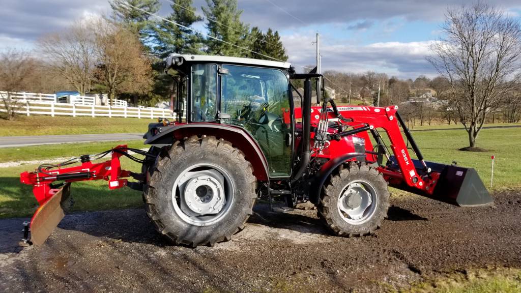

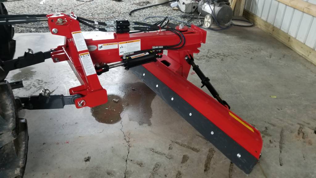

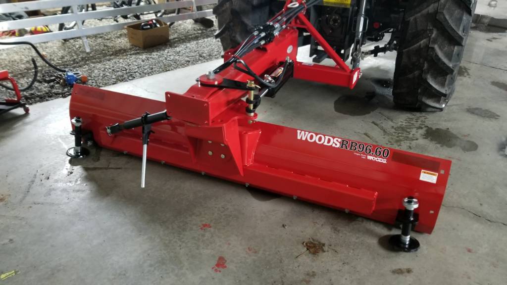

I have a Woods RB96.60. Love it. 20181127_173131.jpeg20181127_173119.jpeg20181203_140453.jpeg
