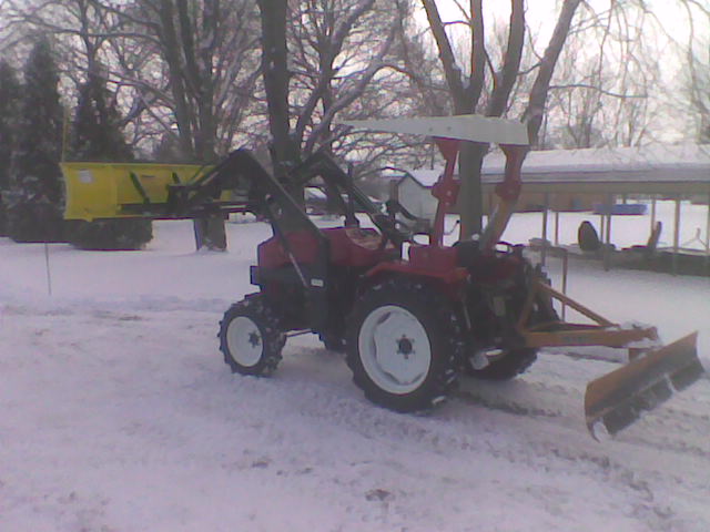

Not sure. I have never moved them in 700+ hours. It works fine with my BH, Bush Hog, Finish mower, Blade, and Post Hole Digger.
Here is the only pic I can find with the blade on it. I will take one tomorrow.
Chris
Chris, from your picture, it looks as though your tractor carries your rear blade very good, but are you sure that the cutting edge is 30" off the ground? It looks more like 12"-16" at most. :confused:
