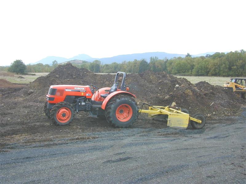

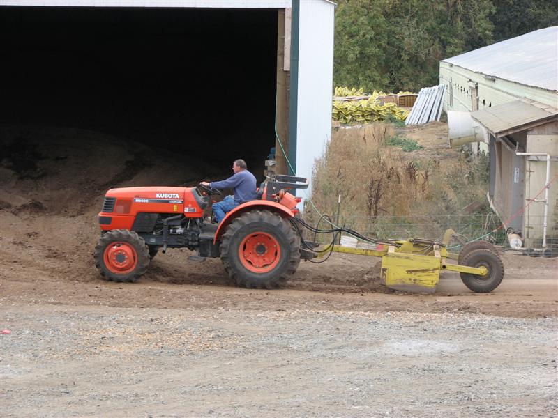

I’m not sure if I have a close up of my leveler but one picture is of my dad using my leveler to pull manure out of one of my poultry barns and the other is a closer picture of when I used it to smooth gravel when we built our manure shed. Most the time we use it to level the barns out after we are done cleaning them. It makes the litter in the barns as smooth as can be by knocking off the high spots and filling in the low spots. I have also used it for smoothing roads and dirt. It does need a hydraulic remote from your tractor to raise and lower the blade. My brother and I built this one for about $400 but they cost about 2000 new. I couldn't do without it.
