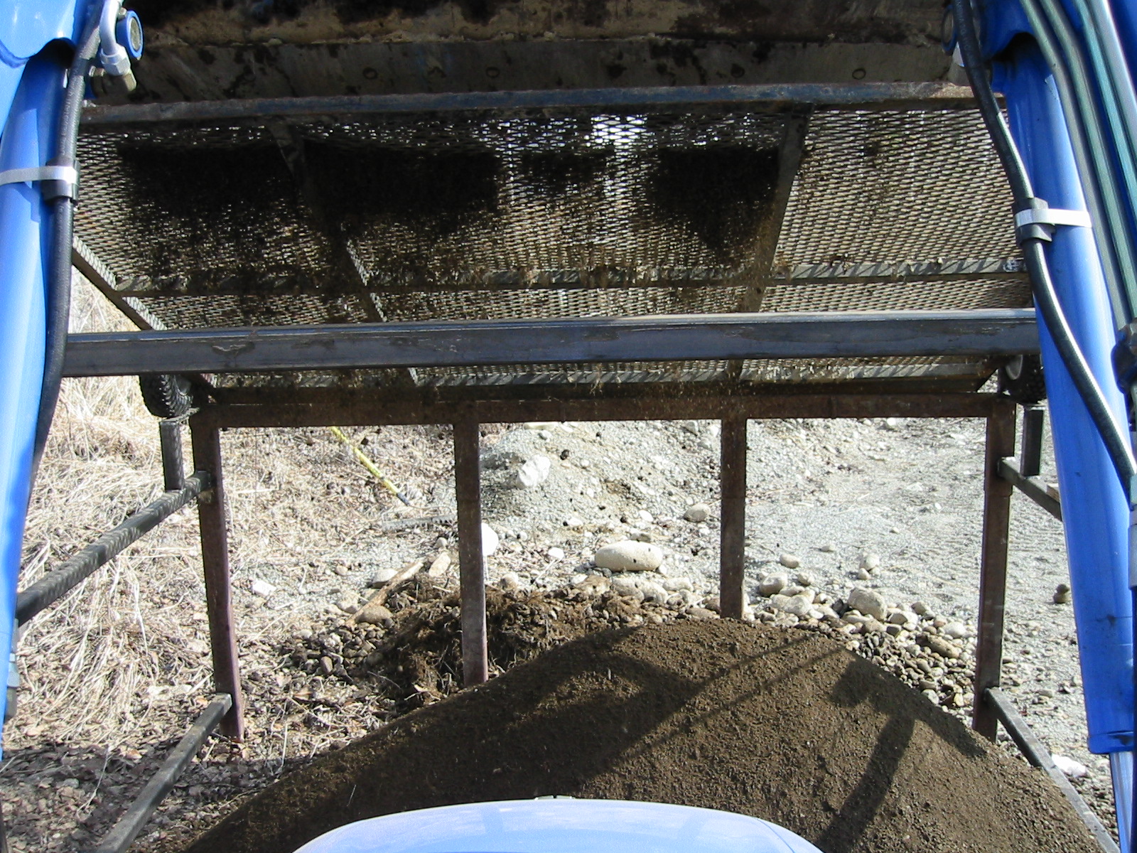

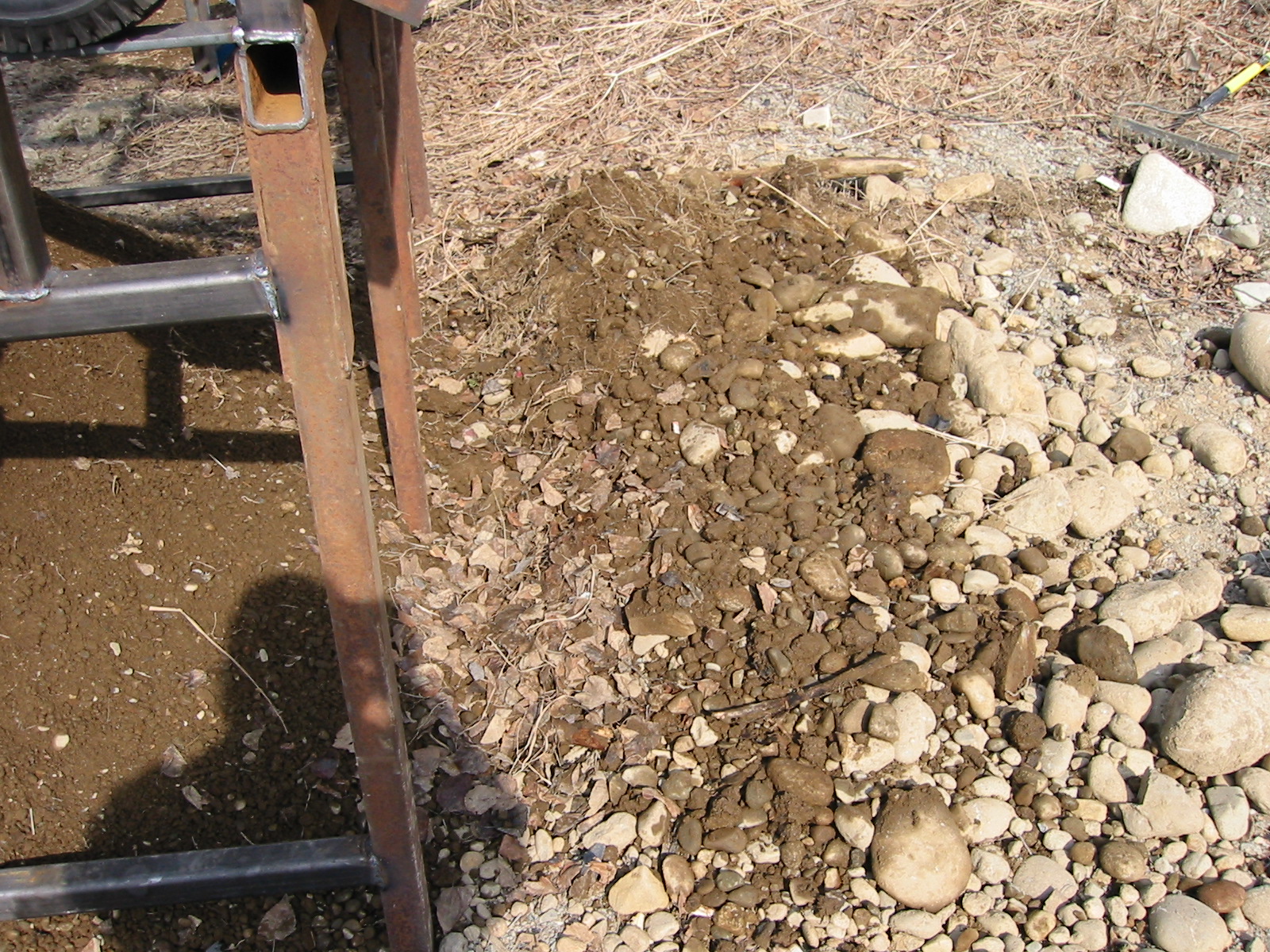

Looks to me like it worked very well. You have two piles: fines with topsoil and sewer rock. What more could you ask for? Great job.:cool:

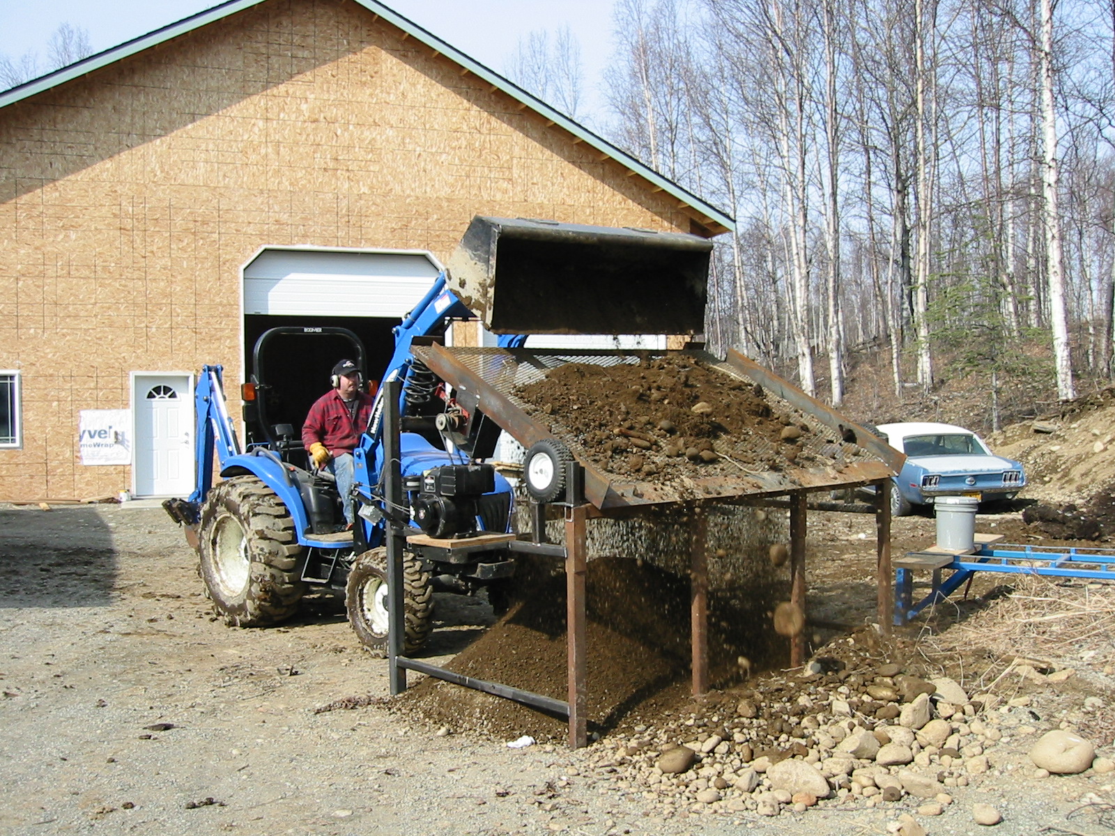

Well, I'm finally done and it works great!! I've screened 30-40 yards with no hiccups. I think I will build a engine guard, to keep an errant rock from hitting the engine.

That looks very nice. That is a job well done!! :D It looks like you barely have enough lift to carry it.;) Now Cindy can have her flower beds with nice topsoil.

[What is the angle of the shaker tray?
Is there any reason you picked this particular angle?
What would you do differently, if anything, if you had to start over?[/QUOTE]
The tray is on it's middle( 24,30 & 38 degree) setting about 30 degrees. I would like to say there was good math or science behind that decison, however, I'm not that smart:) I think it depends a lot on the material your screening and the size of screen your using, I am losing a small amount of product of the back of the screen, at that setting so today I think I will move it down to the 24 degree setting and try it to see if it makes much of a difference.
What would I do differently? it's a little tall, I would probably shorten it about 6-10 inches as is, I put a scoop of dirt for the front tires to run up on. the screen i'm using now is welded to the frame, so somday I will beef up the frame and make it so I can bolt on different screens, but all in all i'm pretty happy with it. I added a pic to show the angle adjustment a little better

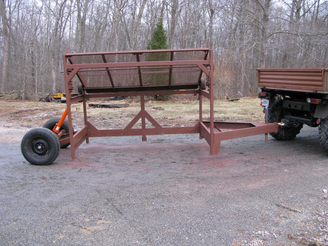

Can you post the picture of your idler/tensioner. I added a tongue and axleloadside.jpg
