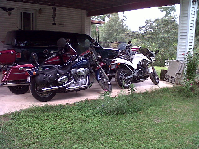

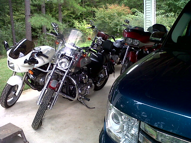

MotorSeven,
I thought they were posted here somewhere, maybe not... My bad!:ashamed:
Here are my OTHER Tractors... :D:D
David
