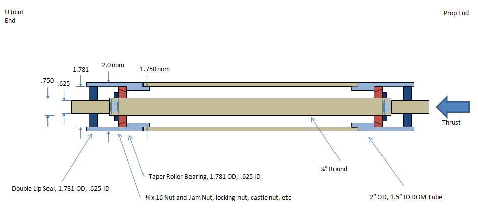

Ok, so my first caveat is this isn't 100% related to my tractor, but I'm going to use tractor parts to build, so I'm hoping I can ask this here. I'm building a long tail mud motor for my duck boat and I was hoping to get some advice on seals. The arrangement is basically a 6.5 hp Honda motor, coupled to a U Joint, coupled to a 3/4" x 60" driveshaft, coupled directly to a prop.
The driveshaft will sit in a 2" DOM housing, suspended by tapered roller bearings on either end (to take thrust load of the prop). Outboard of the bearings, I plan on using double lip seals to seal out water, in grease/oil/atf (haven't decided on lubricant yet). My question - is there any hope of the seal lasting as the prop will be run 1:1 off the motor (3200 RPM's). I've contemplated having the OD of the shaft ground to improve surface finish, but it of course will add cost. This is really only important at the prop end, as it will reside in the water - but I will also have a seal at the motor/ujoint end to keep lubricant in the bearings.
Second question, any reccomendations on U-Joints? The angle will be 12 - 14 degrees from the driveshaft to the motor, and again, WOT is 3200 rpm's (possibly a bit more if everything works well, and I can turn down the governor a bit). I know I need to go with a needle bearing unit, but beyond that - can a standard PTO shaft UJoint from TSC hold up to that RPM and loading?

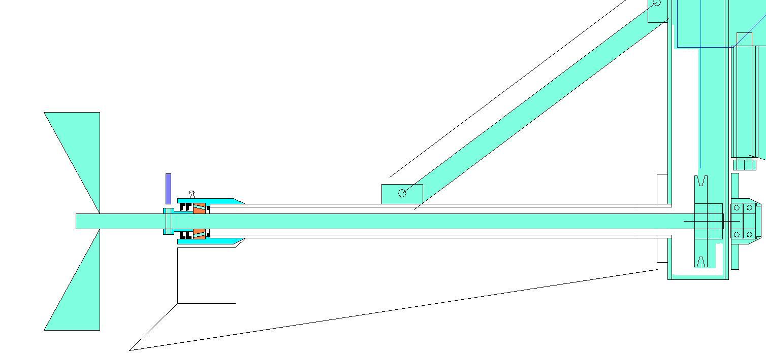

Cool, someone else here wants to build one of these! I have been working in AutoCad ironing out these details also. I have two designs in process, a long-tail like yours and a short-tail like a Mud Buddy and others.
I am concerned about the rpm spec for "tractor" u-joints; these are typically rated at 540, not 3200 - 3600. I bet this is due to balancing.
One option you might consider is to put your thust bearing at the top of the shaft and use a bronze or teflon type radial bushing at the base. This would eliminate the need for good seals and eventual bearing failure at the prop end. It would be easier to keep sealed at the top (not submersed).
Here is quick sketch of one of my bearing mounts (not complete) for a short-tail. I plan to use two outboard seals and one inboard of the bearing. The bearing would have a grease zert on top. The seals ride on a raised bushing that has to be pinned or somehow attached to the drive shaft to transfer the thrust load to the bearing - and be removable to service the bearing. This would have to be water tight of course. At the other end the drive shaft is supported by radial ball bearings (belt drive for short shaft).

You building the boat too?

MWB - I see one issue with your design - I had the same issue and it's been my biggest stumbling block. The tapered roller bearings have to be preloaded somehow to a specific amount - the size I'm looking at (.75 ID, 1.781 OD) needs a preload which will equate to approx 140 deg F free running temperature. The only way I've been able to come up with is to use tapered bearings at both ends and preload them with jam nuts towards each other. Otherwise, you have nothing to push/pull against. I'll try to add a diagram of what I'm planning (it isn't in CAD, but hopefully will convey the driveshaft arangement). Take a look and let me know what your thoughts are.
Also, I have to ask, as I have been going back and forth - have you decided on long vs short tail? I have weighed the pro's and con's of each, and figured they were dead even. I'm going with the long tail as it seems easier to build. But my mind isn't set in stone if you have differing thoughts.

   / Seal and UJoint Advice #11
You won't have to worry about preload unless you intend to have reverse. My drawing is not the complete assembly, I am currently working out dimensions of various components and fitting them to close-to-stock steel. I have a small lathe but I would like a design that does not require significant machining (I like to post designs like this and use the KISS principle to make it easy for others to build also).
At the ball bearing end I would install a belleville washer and nylock nut to remove slack from the assembly but preload would be near zero.
My tapered bearing is a standard trailer bearing (3/4"), the seals are a standard trailer axle seal.

MWB - I agree wholeheartedly on the KISS approach. In this case, I'm shooting for KICASS (keep it cheap and simple...) - but I am still thinking the preload will be needed to prevent ball skid. Ball skid will take out a bearing faster than most any other failure mode, and the tapered roller bearings are succeptible to it if there is any chatter/loosness in the assembly. I haven't found good references on what the preload force needs to be - other than to set it to run at a certain free running temperature. That said, your spring washer may very well provide all the preload nessecary. I'm going to look into this some more and see if I can figure a way to apply it to the long tail design.

My thought is that the propeller will provide all the preload (unless the prop is out of the water). I don't think a relatively low use device would be that hard on bearings (because of no preload) - and the bearings are really cheap to replace anyway. You wouldn't normally run it long with the prop out of the water. I think seal leakage and lubricant failure, or exceeding axial load specs would cause failure long before the bearing would fail due to no preload.
